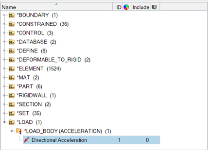

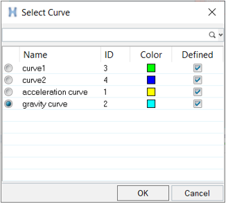

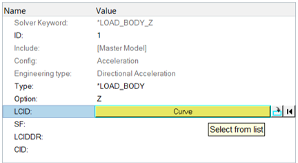

Define Gravity Acting in the Negative Z-Direction
In this step, you will define gravity acting in the negative z-direction with *LOAD_BODY_Z.
Define the Seat Acceleration
In this step, you will define the seat acceleration with *BOUNDARY_PRESCRIBED_MOTION_NODE.
