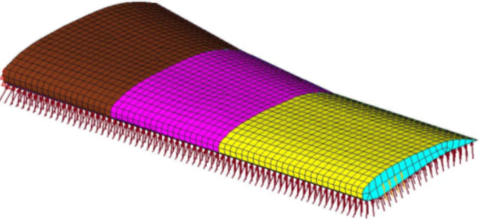

Figure 1. Horizontal Tail Plane Model

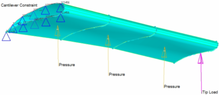

It is assumed that the tail is cantilevered about its inboard section. Three loading scenarios are considered; one where the tail experiences pressure loads of 0.25 psi on the bottom skin, a second where the tail experiences a tip load of 400 lbs, and a third where the tail experiences both the pressure load and tip load simultaneously. The applied loading is represented in Figure 2.
Figure 2. Loading Experienced by Horizontal tail plane

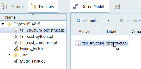

  4. Add a Parameterized File model.
    1. From the Directory, drag-and-drop the tail_structure_optistruct.tpl file into the work area.
      Figure 3.
    2. In the Solver Input File column, enter tail.fem.
      This is the name of the solver input file HyperStudy writes during the evaluation.
    3. In the Solver Execution Script column, select OptiStruct (os).

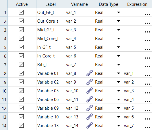

  9. Link input variables.
    1. Click the Links tab.
    2. In the Varname column, copy all of the independent variables (all variables from Model_1).
    3. In the Expression column of all of the dependent input variables (all variables from Model_2), paste the independent variables.

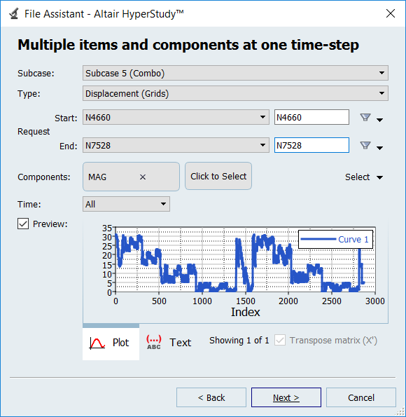

    1. From the Directory, drag-and-drop the tail.h3d file, located in approaches/setup_1-def/run__00001/m_1, into the work area.
    2. In the File Assistant dialog, set the Reading technology to Altair® HyperWorks® and click Next.
    3. Select Multiple Items at Multiple Time Steps, then click Next.
    4. Define the following options and click Next.
      • Subcase: Subcase 5 (Combo)
      • Type: Displacement (Grids)
      • Request - Start: Select First Request and enter N4660
      • Request - End: Select Last Request and enter N7528
      • Component: Mag.
      Figure 5.

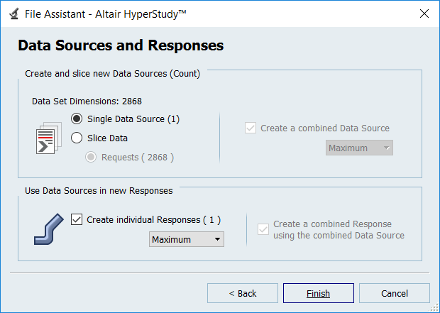

    5. Select the Create individual Responses (1) checkbox, and then select Maximum.
      Figure 6.
    6. Click Finish.

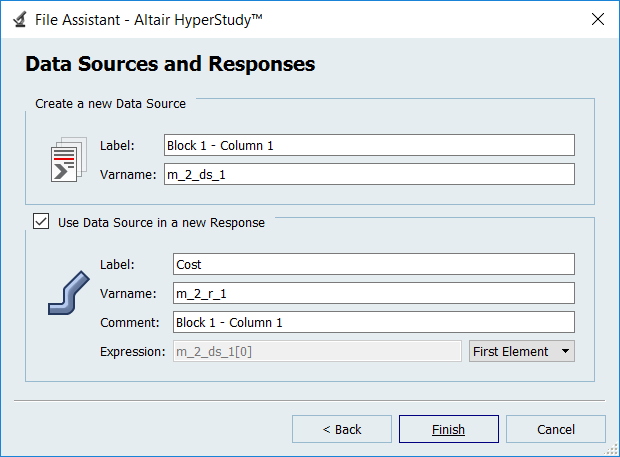

  3. Create the Cost output response.
    1. From the Directory, drag-and-drop the cost.res file, located in approaches/setup_1-def/run__00001/m_1, into the work area.
    3. Select Single item in a time series, then click Next.
      • Type: Unknown.
      • Request: Block 1.
      • Component: Column 1.
      Figure 8.
    5. Label the output response Cost.
    6. Set Expression to First Element.
    7. Click Finish.

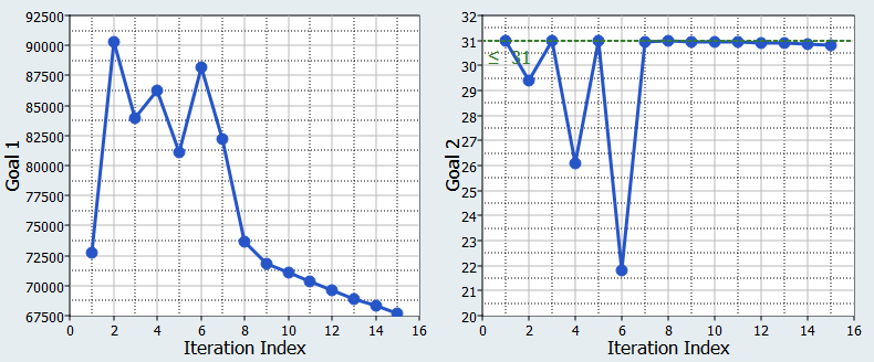

  11. View iteration history of Optimization.
    1. Click the Iteration Plot tab to plot the progress of the Optimization iteration.
    2. Using the Channel selector, select Objective_1 and Constraint_1.
    The evolution of the objective function and constraint vs. iterations is 2D plotted. You can see that the cost of the horizontal tail plane is reduced from 72715 to 67700 (7% reduction), while keeping the structural performance the same.
