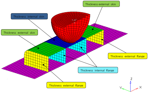

This model simulates the dynamic impact of a sphere with an initial velocity on a
box. There are eight variables: four size variables, which are four box thickness,
and four shapes variables. Figure 1. Size Variables Figure 2. Shape Variables

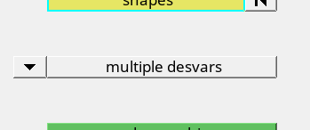

Go to the desvar subpanel and switch single
desvars to multiple desvars.

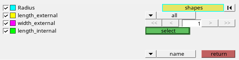

Click the shapes collector.
Figure 4.
Select all of the shapes.
Figure 5.
Click select.
Click create.
A shape design variable is created for each shape.

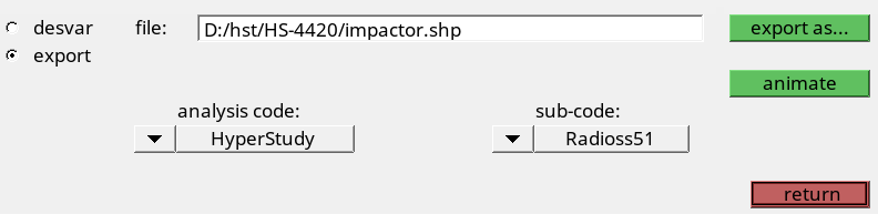

Export and save shapes.
Go to the export subpanel.
For analysis code, select HyperStudy.
For sub-code, select Radioss51.
In the File field, enter impactor.shp.
Click export as.
In the Save As dialog, navigate to your working
directory and save the file as impactor.shp.

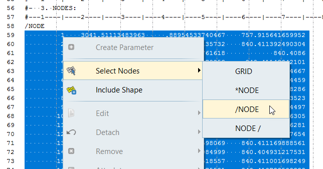

Right-click anywhere in the editor and select Select Nodes > /NODE from the context menu.
All of the /NODE cards in the impactor_0000.rad
file highlight. Figure 8.
Right-click on the highlighted cards and select Include
Shape from the context menu.

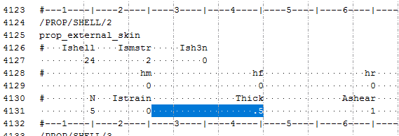

Select the thickness value for
prop_external_skin.
In a RADIOSS deck, each field within a card is 20 characters
long.
Tip: To assist you in selecting 20-character
fields, press Control to activate the
Selector (set to 20 characters) and then click the
value. Figure 9.
Right-click on the highlighted fields and select Create
Parameter from the context menu.

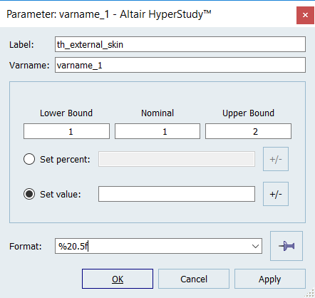

In the Label field, enter
th_external_skin.
Modify bounds.
Lower Bound: 1.0
Nominal value: 1.0
Upper Bound: 2.0
In the Format field, enter %20.5f.
Click OK.
Figure 10.

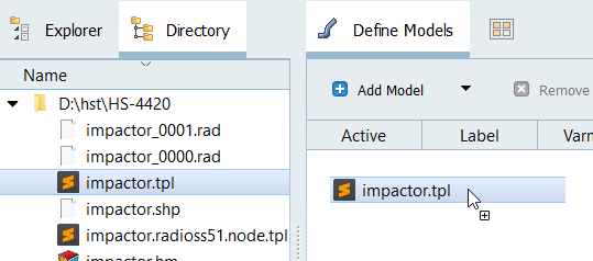

Go to the Define Models step.
Add a Parameterized File model.
From the Directory, drag-and-drop the impactor.tpl
file into the work area.
Figure 11.

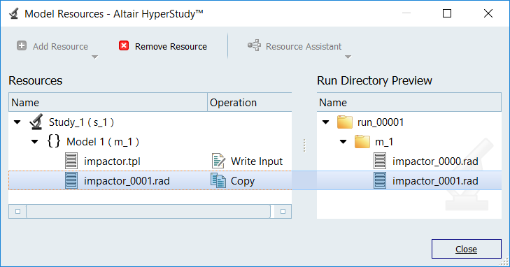

Define a model dependency
Click Model Resources.
The Model Resource dialog opens.
Select Model 1 (m_1).
Click Resource Assistant > Add File.
In the Select File dialog, navigate to your
working directory and open the impactor_0001.rad
file.
Set Operation to Copy.
Click Close.
Figure 12.

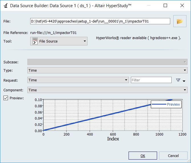

Create a file source for time.
Click the Data Sources tab.
From the Directory, drag-and-drop the impactorT01
file, located in
approaches/setup_1-def/run__00001/m_1, into the
work area.
The Data Source Builder dialog
opens.
For Tool, select File Source.
Define the following options:
Type: Time
Request: Time
Component: Time
Click OK.
Figure 13.

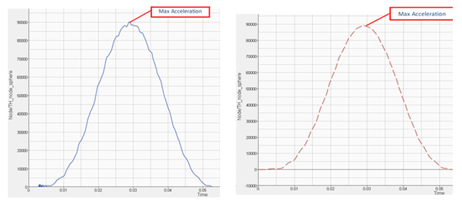

All of the result vectors for the Max_Acceleration output response are
created. The left graph seen in Figure 14 has some noise. To eliminate the noise, you will use a filter
and work on the filtered output response as demonstrated in the right graph shown in
Figure 14. Figure 14.
Add two output responses.
Click the Define Output Responses step.
Click Add Output Response twice.
In the work area, change the labels for the output responses to
Max_Acceleration and
Max_Displacement.
Figure 15.
Define the Max_Acceleration output response.
In the Expression column of the output response Max_Acceleration, click
In the Expression Builder, click the Functions
tab.
From the list of functions, select
saefilter.
This function will apply a filter to the acceleration vector.
Click Insert Varname.

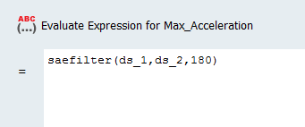

The function saefilter(,,) appears in the Evaluate Expression
field. You can now add the time vector and the acceleration vector as
arguments to the function, with a class parameter of 180.
In the Evaluate Expression field, enter
(ds_1,ds_2,180) in the saefilter
function.
Figure 16.
To calculate the max of the expression, add the max function to the
beginning of the expression.
The expression should read:
max(saefilter(saefilter(ds_1,ds_2,180)0)).
To express the result in G, divide the max of the expression by
9810.
max(saefilter(ds_1,ds_2,180)/9810).
Click OK.

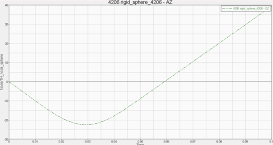

Define the Max_Displacement output response.
Optional: Plot the displacement with respect to the time, to obtain the curve
illustrated below:
Figure 17.

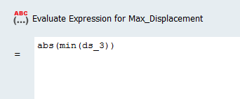

In the Expression column of the output response Max_Displacement, click
tab.
From the list of functions, select abs.
The function abs() appears in the Evaluate Expression
field.
From the list of functions, select min.
The expression should now read,
abs(min()).
In the Evaluate Expression field, enter ds_3 in
the min function.
Figure 18.
Click OK.

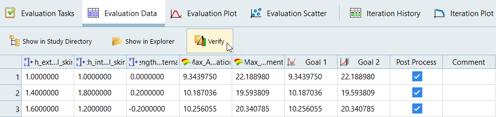

Click Evaluate to extract the response values.

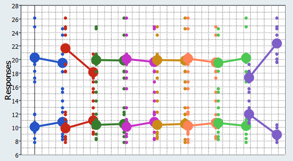

Click the Linear Effects tab to review the linear
effects.

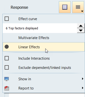

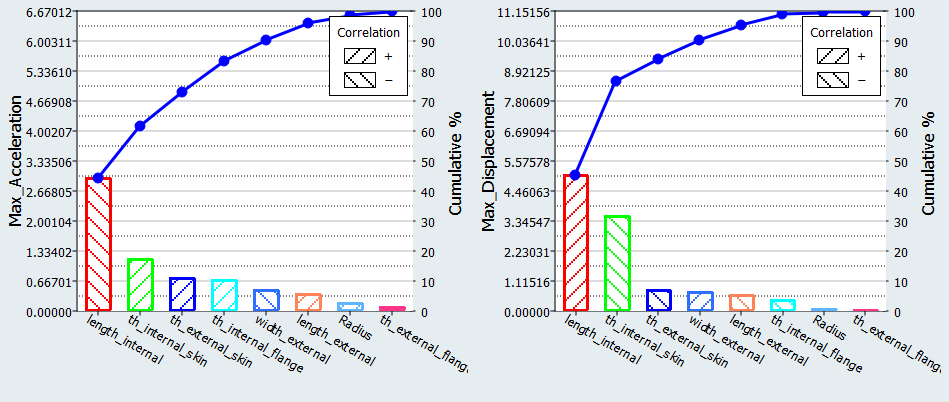

Observe the main effect of the input variables on both output responses. Figure 20.
Click the Pareto Plot tab, then use the
Channel selector to select both of the output
responses.
A linear effects plot and a pareto plot with the Linear
Effects option enabled (shown in Figure 21) provide the same
information. However, with a pareto plot, you can use a statistical measure
(that is, the 80-20 rule) to decide which input variables are more significant
and which input variables can be neglected. Figure 21.
For this tutorial, you will use the 80/20 rule to eliminate input
variables that are not significant to the study. The 80/20 rule is a Pareto
principle that proposes 80% of the total effects comes from only 20% of the
variables.
Note: You should also use other practices to eliminate input
variables that you feel should be taken in consideration.
For screening purpose, you can see which input variables contribute to 80% or
more of the given output response. In Figure 22 you can see the
following:
For Max_Acceleration, the input variables length_internal,
th_internal_skin, and th_external_skin contribute to 80% of the linear
effect.
For Max_Displacement, the input variables length_internal and
th_internal_skin fall under the 80/20 rule.
For n responses, you can list out the input variables that follow the 80/20
rule, and take union of the sets. In this case, the input variables that follow
the 80/20 rule include: length_internal, th_internal_skin, and th_external_skin.
This narrows your list to three significant input variables. Figure 22.

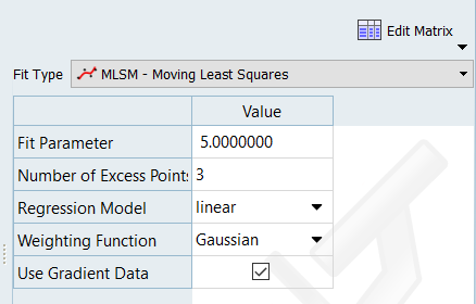

In the work area, Fit Type column, select Moving Least
Squares (MLSM) for all output responses.
Figure 25.
In the Settings tab, verify that Regression Model is set to
Linear for all output responses.
Note: It is advisable to start with lowest order and increment it in
case model Residuals and Diagnostics do not look feasible.
Figure 26.
Click Apply.

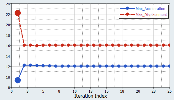

Click the Iteration Plot tab to monitor the Optimization
iteration.
Figure 30.
Click the Iteration History tab to review a table of
each iteration.
The iterations that do not respect the constraint are displayed red, the
optimal design is displayed green.
Run Verification
In this step, you will run a Verification to check if the solution found by the
approximation is close to the solver results.
Add a Verification.
Go to the Optimization > Evaluate step.
Click Verify.
Figure 31.

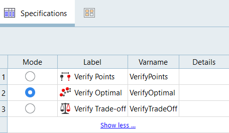

Go to the Verification > Specifications step.
In the work area, set the Mode to Verify Optimal.
Figure 32.
Click Apply.
Go to the Verification > Evaluate step.
Click Evaluate Tasks.

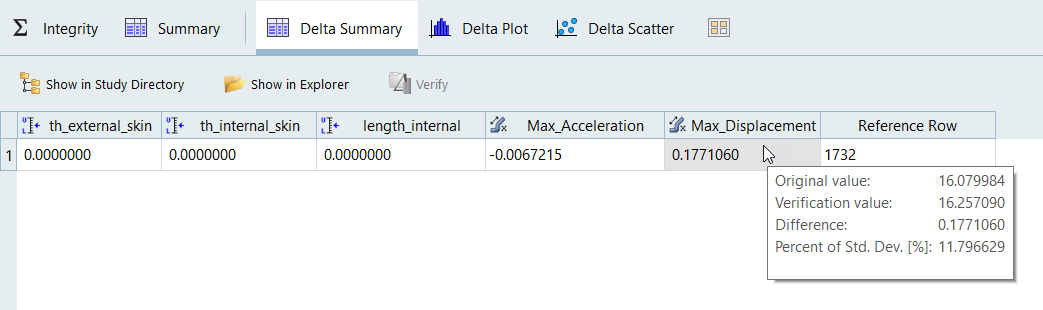

Go to the Verification > Post-Processing step.
Click the Delta Summary tab.
Hover your cursor over the value of the Max-Displacement
column to review the difference between the fit predicted values (original
value) and the solver run results (verification value).
As shown in Figure 33,
there is a small difference in displacements. Figure 33.
