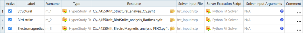

Add a HyperStudy Fit model.
- From the Define Models step, click Add Model.
- In the HyperStudy - Add dialog, select HyperStudy Fit model and click OK.
- In the Label column, change the name to Structural.
In the Resource column, click
- In the HyperStudy - Load model resource dialog, select fit_Structural_analysis_OS.pyfit and click Open.
Figure 1.The HyperStudy Fit model is created and a Python Fit Solver is automatically populated in the Solver Execution Script column. -
Add two more HyperStudy Fit models by repeating step 3, except change the label and resource for each model as
shown in Table 1.
Table 1. Label Resource Bird strike fit_Birdstrike_analysis_Radioss.pyfit Electromagnetics fit_ElectroMagnetic_analysis_FEKO.pyfit
Figure 2. -

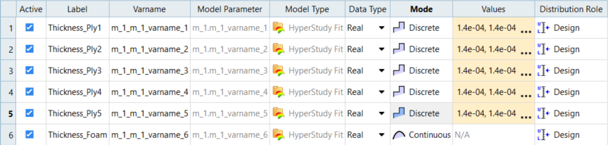

Go to the Define Input Variables step,
Bounds tab and edit the first six variables as shown
in Table 2.
Table 2. Label Lower Bound Nominal Upper Bound Thickness_Ply1 0 1.40e-04 4.2e-04 Thickness_Ply2 0 1.40e-04 4.2e-04 Thickness_Ply3 0 1.40e-04 4.2e-04 Thickness_Ply4 0 1.40e-04 4.2e-04 Thickness_Ply5 0 1.40e-04 4.2e-04 Thickness_Foam 0.001 0.004 0.012 - For all Thickness_Ply variables, click the Modes tab and set the mode to Discrete.
For the Thickness_Foam variable, verify the mode is set to
Continious.
Figure 3. -

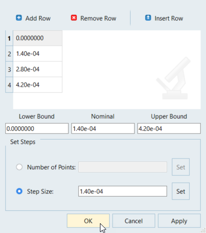

Edit values for all Thickness_Ply variables.
For Thickness_Ply1, click
in the Values column.
- For Step Size, enter 1.40e-04 and click Set.
- Click OK.
- Repeat step 9 for the remaining Thickness_Ply variables.
Figure 4. -

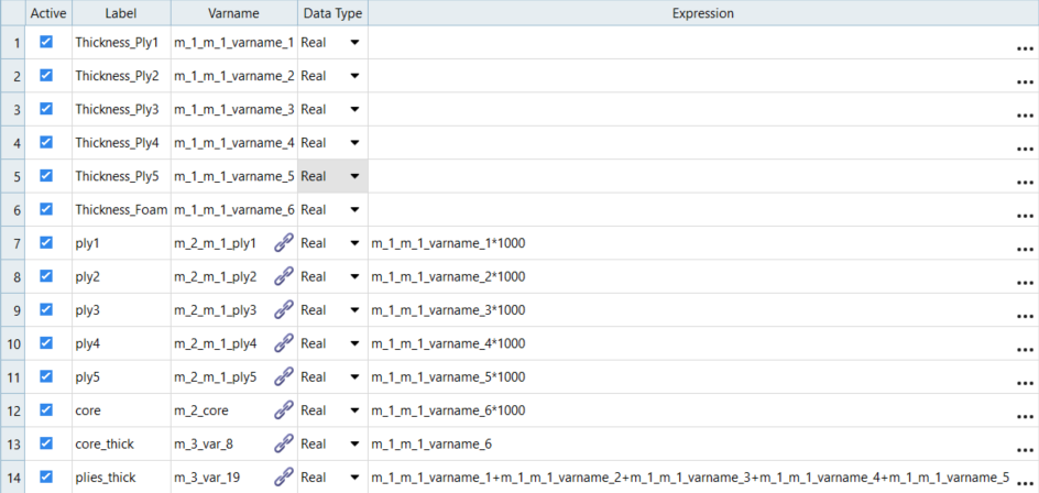

Link variables to ensure consistent variations in different analysis.
- Open the Links tab.

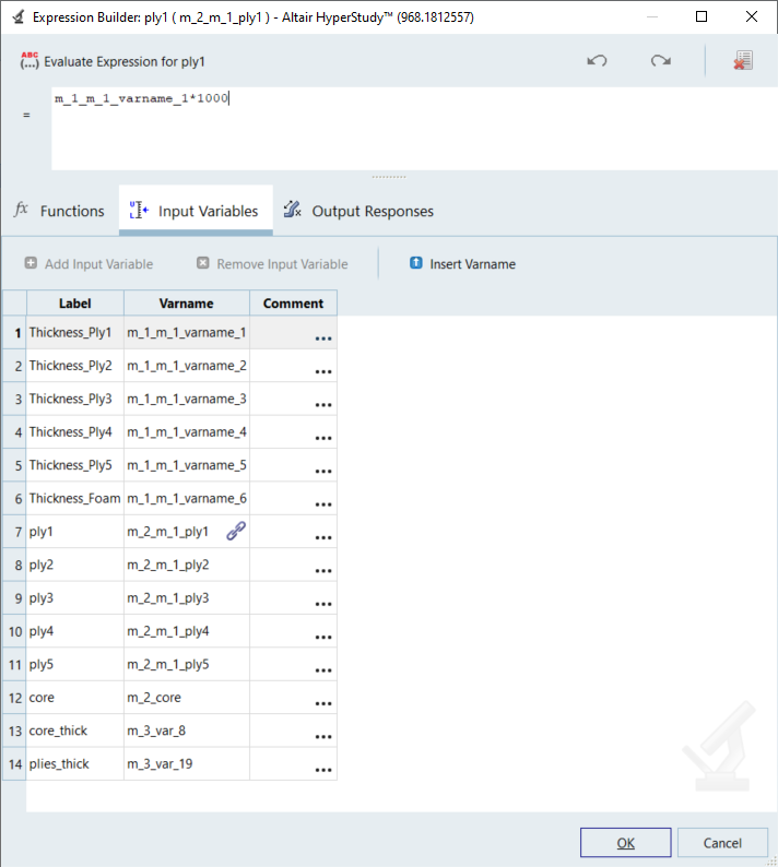

For ply1, click
in the Expression column.
In the Expression Builder dialog, enter
m_1_m_1_varname_1*1000 in the Evaluate
Expression field.
Figure 5. -
Repeat step 10 to define the remaing expressions as shown in Table 3.
Table 3. Label Expression ply2 m_1_m_1_varname_2*1000 ply3 m_1_m_1_varname_3*1000 ply4 m_1_m_1_varname_4*1000 ply5 m_1_m_1_varname_5*1000 core m_1_m_1_varname_6*1000 core_thick m_1_m_1_varname_6 plies_thick m_1_m_1_varname_1+m_1_m_1_varname_2+m_1_m_1_varname_3+m_1_m_1_varname_4+m_1_m_1_varname_5
The variables of the Bird strike and Electromagnetics models are linked to the variables of the Structural model and they will change accordingly within the evaluations.

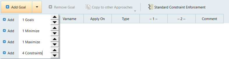

- Go to the Define Output Responses step, Objective/Constraints - Goals tab.
- Expand the Add Goal scroll menu.
- For Minimize, select 1 and click Add.
For Constraints, select 4 and click
Add.
Figure 8. -
