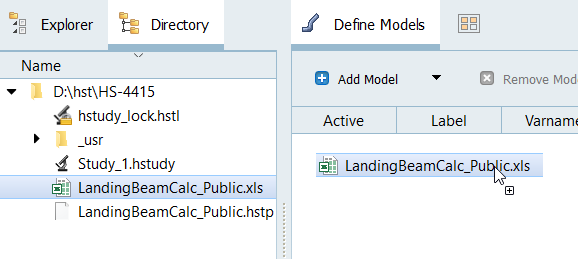

From the Directory, drag-and-drop the
LandingBeamCalc_Public.xls file into the work
area.
The Solver input file column displays hst_input.hstp, this is the name of the solver input file HyperStudy writes during any evaluation. The Solver execution script column now displays SpreadSheet_HST.
Figure 1. - Optional: If a firewall prompt dialog appears, click Allow.
Click Import Variables.
The LandingBeamCalc_Public.xls spreadsheet opens.

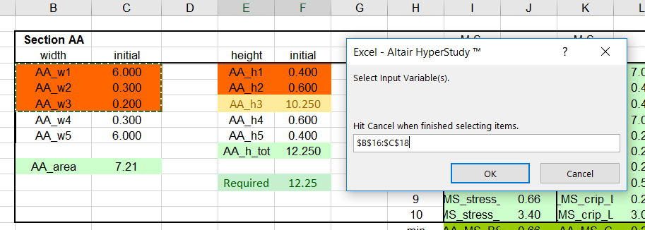

In the spreadsheet, select the cells AA_w1,
AA_w2, and AA_w3 in
Section AA, along with their corresponding values.
Figure 2. - In the Excel - HyperStudy Input Selector dialog, click OK.
Select the following:
- Section AA: AA_h1 and AA_h2
- Section CC: CC_w1, CC_w2, CC_w3
- Section CC: CC_h1, CC_h2
- Section EE: EE_w1, EE_w2, EE_w3
- Section EE: EE_h1, EE_h2
- Click Cancel to stop selecting input variables from the spreadsheet.

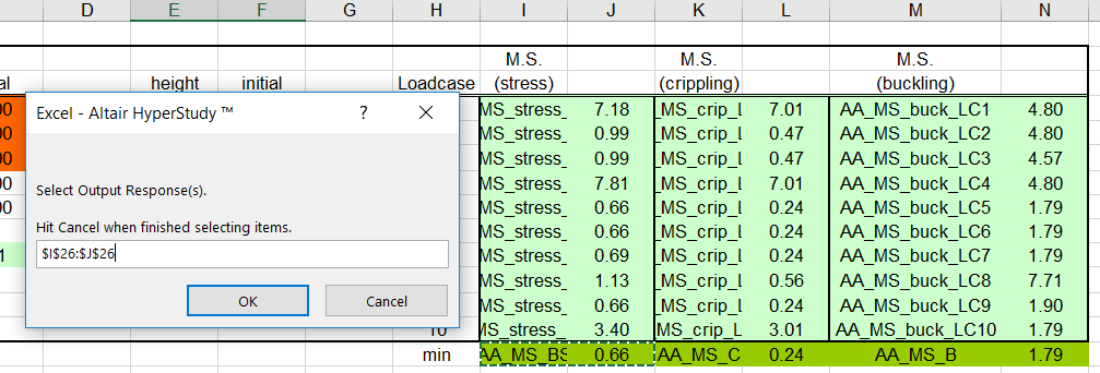

In the spreadsheet, select the cell AA_MS_BS in
Section AA, along with its corresponding value.
Figure 3. - In the Excel - HyperStudy Output Selector dialog, click OK.
- Section AA: AA_MS_C
- Section AA: AA_MS_B
- Section CC: CC_MS_BS
- Section CC: CC_MS_C
- Section EE: EE_MS_BS
- Section EE: EE_MS_C
- Area ACE value (cell C10)
Click Cancel to stop selecting output responses

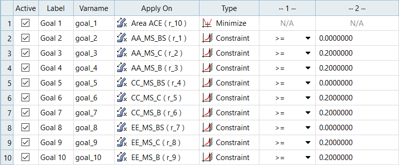

- Click the Objectives/Constraints - Goals tab.
Apply an objective on the Area ACE output response.
- Click Add Goal.
- In the Apply On column, select Area ACE (r_10).
- In the Type column, select Minimize.
Figure 4. -
Apply constraints.
- Click Add Goal nine times.
- Define Goal 2 through Goal 10 by selecting the options indicated in the Figure 5.

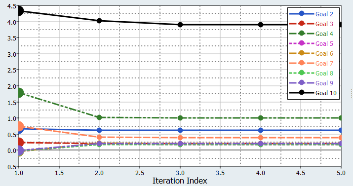

Review iteration history.
- Click the Iteration Plot tab to monitor the progress of the Optimization iteration.
- Using the Channel selector, select Goal 2 through Goal 10.
Figure 6.
