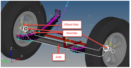

- Wheel
 - Wheel is a circular disc joined to a hub that is mounted on a shaft about which it may revolve and bear a load.
 - Wheel Hub
 - The wheel hub assembly holds the wheel parts together. The assembly contains the wheel bearings, which allows the wheels to turn steadily.
 - Axle
 - An axle is a fixed bar on which a wheel or a pair of wheels revolve.
 - Knuckle
 - It is one of the suspension components which allows the tire to turn
                            with ease. It is type of ball joint located at the end of each
                                tierod.

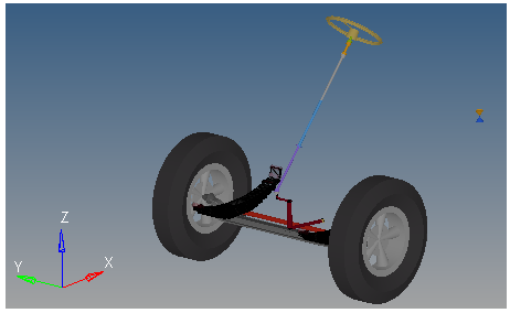

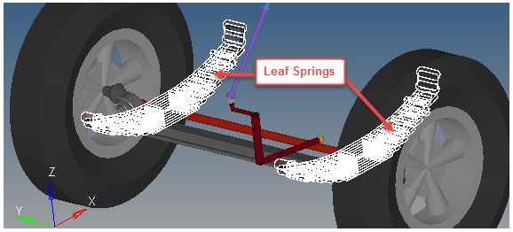

Figure 2. - Leaf Springs
 - Leaf springs are used in front solid axle suspension and are mounted to
                            the frame at two points. The ends of the leaf spring can either tie to
                            the top of the rods, or to the top of the solid axle. The axle receives
                            its vertical support from a leaf spring (leaf springs were often used
                            for support in more than one direction).

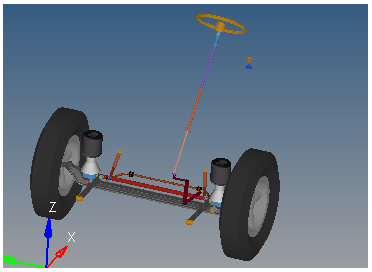

Figure 3. - Front Solid Axle Suspension with Trailing Arm
 - Front solid axle suspension with trailing arm has a suspension system
                            for a vehicle frame having an elongated, supported body (trailing arms),
                            and a steering axle positioned below the supported body to support a
                            portion of vehicle weight. The front solid axle suspension with trailing
                            arm built through the Assembly Wizard is displayed
                            in the MotionView window.

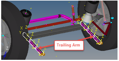

Figure 5. - Trailing Arm
 - Trailing Arm is a suspension element consisting of a longitudinal member
                            with first, second and third arms, each rigidly connected and it pivots
                            from the body at its forward end and has a wheel hub attached to its
                            trailing end.

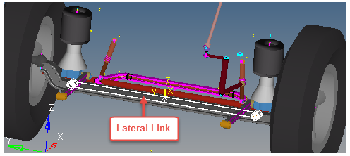

Figure 6. - Lateral Arm
 - Trailing arms designs are poor at maintaining axle position laterally,
                            which makes the use of a lateral link to hold axle position
                                necessary.
