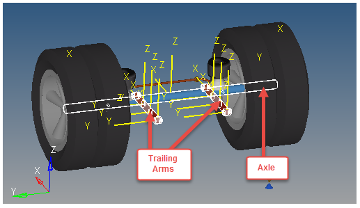

Rear Single Solid Axle Suspension with Trailing Arm
- Trailing Arm
 - Trailing-arm suspension is a design in which one or more arms are
                            connected between the rear axle and the chassis, toward the front of the
                            vehicle. This allows the rear to move up and down.

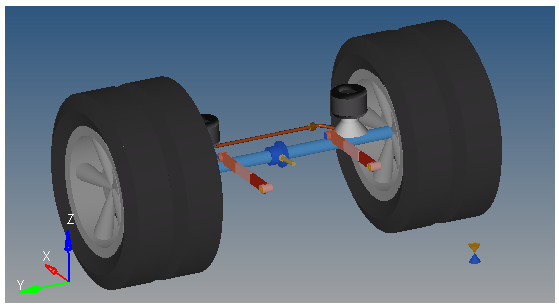

Figure 3. - Air Springs
 - An air spring is also included in the suspension and is located at a load transmitting location between one of the trailing arms and the frame.
 - Bracket
 - A bracket pivotally mounts one end of the trailing arm to the frame of
                            the vehicle while the other end of the trailing arm is joined to the
                            frame by a shock absorber and an air spring. Bracket has the effect of
                            lowering the center of gravity of the suspension and moving the force
                            resisting any sway as far from the frame as possible.

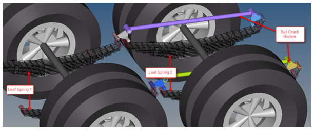

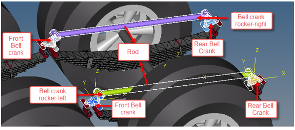

- Bell Crank Linked Leaf Springs
 - In the bell crank linked leaf springs, two sets of leaf springs are used
                            and is mounted to the frame at two points. Bell crank rocker is attached
                            in the rear-rear leaf spring. It is used to convert translational motion
                            of one object into translational motion of another object operating at
                            different angles. It acts as an equalizer when the load is applied.

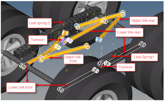

Figure 5. - Inverted Leaf Suspension
 - In this suspension, the leaf springs are inverted than the normal leaf
                            spring suspension. The smallest length leaf springs are attached at the
                            top and the longest stays at the bottom.
