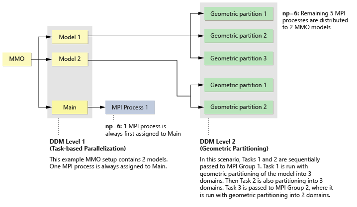

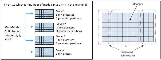

Figure 3. (a) DDM Level 1: Parallelization of MMO Models; (b) DDM Level 2: Geometric Partitioning of Some or all of the MMO Optimization Models. depending on the number of MPI processes and number of MPI groups

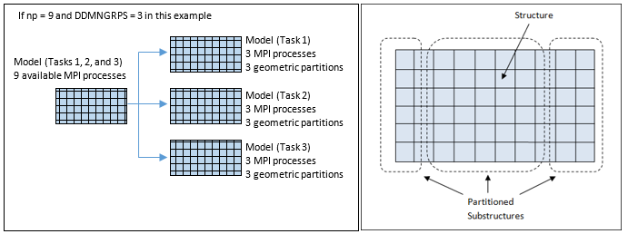

DDM Level 2 – Parallelization of Geometric Partitions
The second level of parallelization occurs at the distributed task level. Each distributed task can be further parallelized via Geometric partitioning of the model. These geometric partitions are generated and assigned depending on the number of MPI groups and the number of MPI processes in each group.
The second level DDM process utilizes graph partition algorithms to automatically partition the geometric structure into multiple domains (equal to the number of MPI processes in the corresponding group). During FEA analysis/optimization, an individual domain/MPI process only processes its domain related calculations. Such procedures include element matrix assembly, linear solution, stress calculations, sensitivity calculations, and so on.
The platform dependent Message Passing Interface (MPI) handles the communication between various MPI processes.

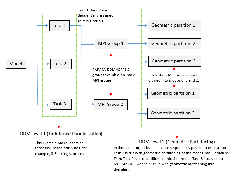

Figure 4. Example DDM Setup with 5 MPI Processes (-np=5) . The model has 3 task attributes (Example, 3 buckling subcases, or 3 DFREQ loading frequencies, etc). PARAM, DDMNGRPS,2 is defined
The necessary communication across domains is accomplished by OptiStruct and is required to guarantee the accuracy of the final solution. When the solution is complete, result data is collected and output to a single copy of the .out file. From the user’s perspective in terms of results, there should be no difference between DDM and serial runs in this aspect.
Figure 5. Example DDM Setup with 6 MPI Processes (-np=6). The MMO setup has 2 models. PARAM,DDMNGRPS should not be used in conjunction with MMO

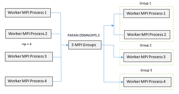

For a default DDM run (PARAM,DDMNGRPS,AUTO) or if PARAM,DDMNGRPS,# is specified to identify the number of MPI groups, hybrid DDM parallelization is typically active. Both level 1 and level 2 parallelization are performed, depending on the specified -np and the number of MPI groups. PARAM,DDMNGRPS,<ngrps> is an optional parameter and AUTO is always the default for any DDM run. The model is first divided into parallelizable tasks/starting points (refer to Table 2 for supported solution sequences for level 1). Each task/starting point is then solved sequentially by an MPI group. Each MPI group consists of one or more MPI Processes. If an MPI group consists of multiple MPI processes, then the task/starting point is solved by geometric partitioning in that MPI group (the number of MPI processes in a group is equal to the number of geometric partitions. Refer to Supported Solution Sequences for DDM Level 2 Parallelization (Geometric Partitioning) for solutions that support geometric partitioning level 2 DDM).

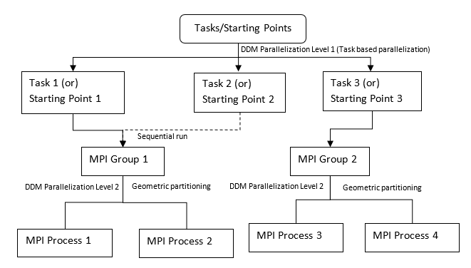

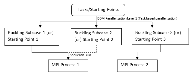

Figure 6. Example of 3 Buckling Subcase Model (or 3 Starting Points in DGLOBAL). First Level of DDM Parallelization: -np 2 -ddm with PARAM,DDMNGRPS,MAX (assign geometric partitions/starting points to DDM MPI processes, sequentially)
Figure 7. Example of 3 Buckling Subcase Model (or 3 Starting Points in DGLOBAL). Hybrid DDM with 2 Levels of Parallelization -np 4 -ddm, and PARAM,DDMNGRPS,2 (assigns 3 Buckling subcases/starting points to DDM MPI groups, sequentially. Subsequently, geometric partitioning is done within each MPI

Optimization models are parallelized wherein extra MPI processes (> no of models plus 1) are distributed evenly to models in main MMO file (or user- defined -np for each model in main file). Any MMO optimization model is geometrically partitioned and solved in parallel (number of partitions depends on number of MPI processes/np assigned to it). There is no grouping via PARAM,DDMNGRPS as it is not supported for MMO. However, grouping is indirectly accomplished by automatic distribution of np to the MMO models or by explicit user input via Main file.
