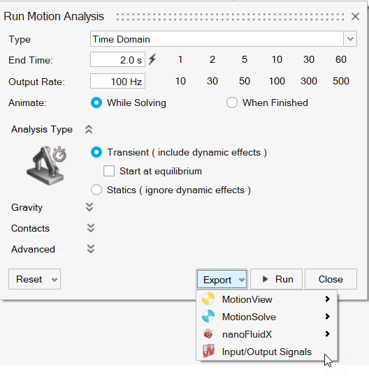

Export Motion Results
Export motion analysis results using the Export button on the Run Motion Analysis window.
You can also export plots and other data in CSV format by selecting a plot.
Export the Motion Model
Export the motion model with analysis settings as a MotionView file (.mdl), MotionSolve py file (.py), or nanoFluidX position file (.txt).

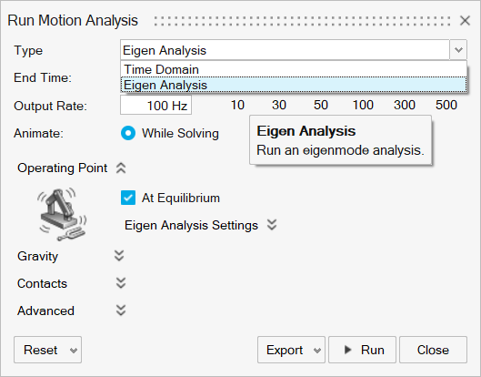

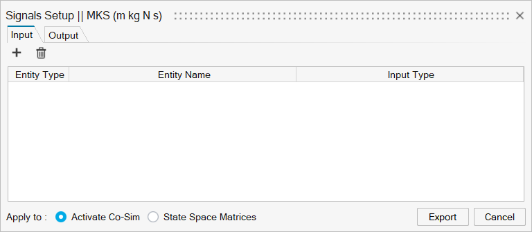

Define and Export Input/Output Signals
Define and export Input/Output signals for solving a State Space Eigen analysis in Inspire, or set up a Co-Simulation with Activate (.py file).

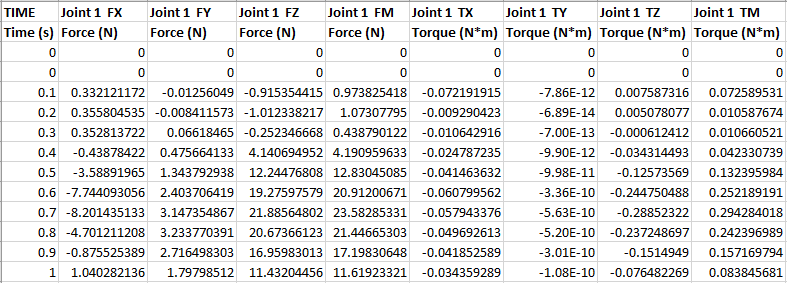

Export Plots, Images, Loads, and Locations
Export results data such as plots, images, loads and locations in various formats.
- If you make a change to the model that requires running a reanalysis, the check icon disappears, and you will not be able to export plot data until you run another motion analysis.
- Plot settings on the Run Motion Analysis window must be set to All and
Global in order to export loads on parts. Otherwise the Export Loads option
is disabled in the plot context menu for the chart. Below is an example of a sample .csv file.
