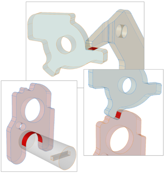

will be shown instead. - If initial intersecting parts are found between visible parts (not hidden
parts), a warning message is displayed.
Initial intersections between parts can present difficulties in solving contact models and affect the accuracy of results. If you select Review, a guide bar appears. The first button says Intersections (n), where n equals the number of intersections found. To review the intersections, click the following buttons:
Go to Next: Go to
the next intersection.
Go to Previous:
Go to the previous intersection.

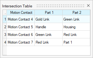

List
Intersections: Display the Intersections Table,
which lists the intersecting parts of all visible motion contacts in
the model. Click on a name in the table to review the corresponding
intersection in the modeling window.
One part has a blue dotted outline, while the other part has an orange dotted outline. The intersection is displayed in red.
