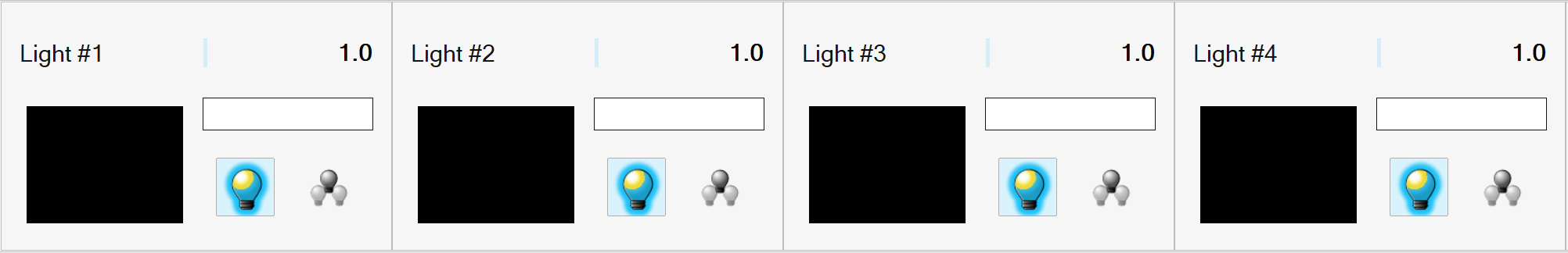

                A thumbnail preview of each light or group of lights is displayed to the right of the animation timeline.
                Modify the lighting to create a key:
To Do this Note Define the intensity of a light - When you hover the mouse over the number below the light's name, a double-headed arrow appears. Drag the arrow to the left to decrease the intensity, or drag the arrow to the right to increase the intensity.
 - Double-click the number below the light's name, and then enter an intensity.
The default intensity is 1. Change the color of a light Click the rectangle below the number. Select a color, which will be blended with the existing color of the light. For example, if the light was originally red and you select blue, the light will be purple. To avoid blending colors, use the default color of white. Turn on or off a light Click On or Off. To turn on a light and turn off all other lights, click Solo. The other lights that are turned off appear grayed out.  - To add the current key to the timeline, click a frame, and then click Add Key Frame.
