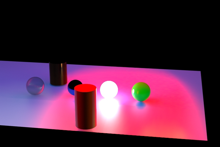

Figure 1. Without NLM Denoiser. Noise is visible, especially on the plane.
Figure 2. With NLM Denoiser. Noise is reduced; the plane is cleaner.
