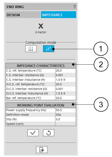

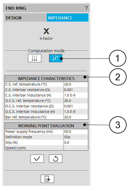

Constant computation mode
When constant computation mode is set, the inter-bar end-ring resistance and inductance values must be set by the user.
The values are given for a reference temperature.
In this case the inter bar end ring resistances and inductances are only a function of the temperature (function depending of the material of the end-ring).
END RING – Constant computation mode | |
1 | Automatic computation mode selection |
2 | Impedance characteristic to be defined |
3 | Working point evaluation for which the impedances will be computed (optional) |
