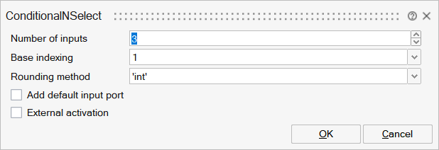

ConditionalNSelect_0
nin
Number of inputs
Number of inputs to be copied to output.
Number
base
Base indexing
When 0 is selected, the index counts from 0, the 2nd input is labled case 0. When 1 is selected, the index counts from 1.
Scalar
0
1
rule
Rounding method
Method for rounding the control signal to an integer, when the control signal is a non-integer.
String
'int'
'round'
'ceil'
'floor'
add_default
Add default input port
Add a default input port. If the control does not match any of the inputs, the default input is used.
Number
0
1
externalActivation
External activation
Specifies whether the block receives an external activation or inherits its activation through its regular input ports. When External Activation is selected, an additional activation port is added to the block. By default, external activation is not selected.
Number
0
1
y
explicit
output
1
switch u1
explicit
input
1
Port 3
explicit
input
nin+add_default
Port 4
activation
input
externalActivation
