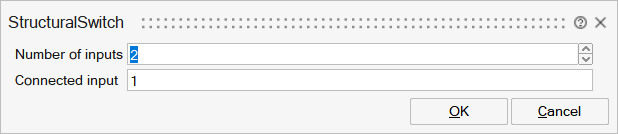

n
Number of inputs
Number of block inputs.
Number
k
Connected input
Input from where the output signal inherits the input signals.
Scalar
