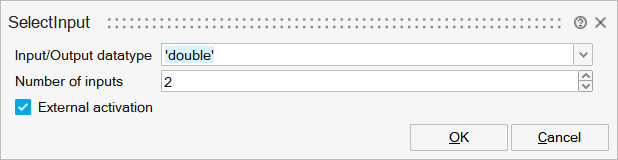

nin
Number of inputs
Specify the number of input signals to be selected.
Number
externalActivation
External activation
The same number of activation inputs as regular inputs are added to the block when selected. The external activation determines which input to be copied to the output. Default is OFF.
