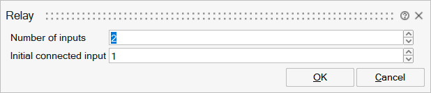

Relay_0
nin
Number of inputs
Specify the number of input signals to be selected.
Number
z0
Initial connected input
The input initially connected to the output.
Number
