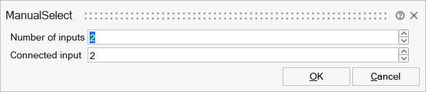

ManualSelect is a manual Switch block. It selects one of its inputs to pass through to the output. The selected input is propagated to the output, while the unselected inputs are discarded.
ManualSelect_0
nin
Number of inputs
Number of inputs to be selected.
Number
z0
Connected input
The number of the input port to be passed to the output.
