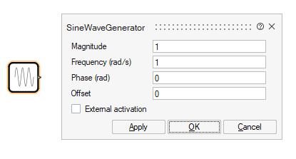

The following dialog shows you the parameters you can set for a SineWaveGenerator block. For example, you can set an exact numerical value for the amplitude:

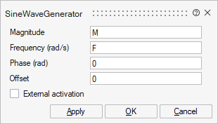

You can further parameterize the block by setting the Magnitude to M and the Frequency to F, where both M and F are model parameters that can be defined in the model context.

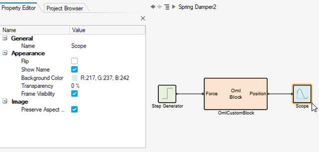

Modify Properties in the Property Editor
Use the Property Editor to modify the name and other display properties of a block.
  1. From the ribbon, select View > Property Editor.
  2. Select a block in a model that you want to modify.
    The Property Editor displays the properties available for the selected block.
  3. In the Property Editor, define the properties that are applicable for your block.

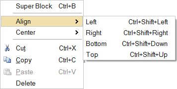

  • To align blocks automatically, cross-select the blocks you want to align. Then on the ribbon from the Alignment tool group:
    select the tool to align to the left , right , top or bottom . Alternatively, right-click and select from the align options on the context menu:

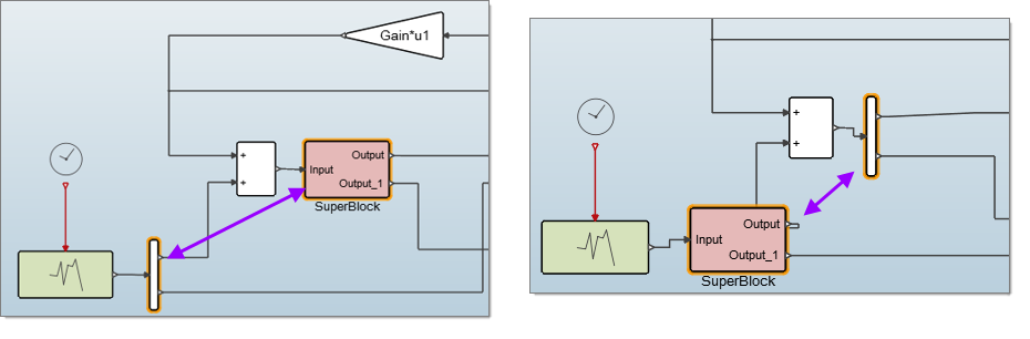

Switching Two Blocks
Switch the placement of two blocks in a diagram.
  1. Select two blocks that you want to reposition in a diagram:
  2. Press Ctrl+T, or right-click, and from the context menu, select Switch.
    The blocks swap places in the diagram:
The following figure shows the switching of two blocks in a model. The software automatically reconnects the blocks in the diagram within the limits of compatibility of the ports on the blocks. Once the blocks are switched, you can adjust the links as needed.
