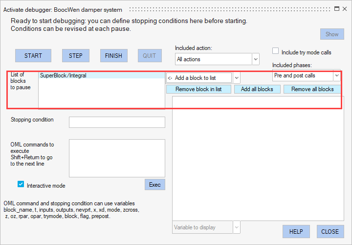

Blocks to pause
One pause condition is to make a list of blocks to pause. The List of blocks to pause is located under the action buttons in the Activate debugger dialog box. To the right of the list are options to add and remove blocks. To add a specific block, select it from the Add a block to the list drop-down list.
By default, the list of blocks to pause in is empty. If the simulation is started or continued using the START or CONTINUE buttons, it either runs to the end or pauses due to an error. The behavior in this case is like that of the FINISH button. If one or more blocks are selected, then a pause cannot occur in any other block other than the selected blocks, unless an error occurs in that other block. Regardless of the chosen filters, if an error occurs during simulation in debug mode inside a block, the simulation is paused in that block.
The correspondence between basic blocks in the list and blocks visible in the diagram is one-to-one for most blocks. When paused, the full name of the block is shown at the top of the dialog box. To open the diagram containing the block, click Show in the upper right. The block is marked with a specific icon in the diagram indicating whether the pause is a pre-call, a post-call, or post-call subsequent to an error. These icons are shown in the image below.

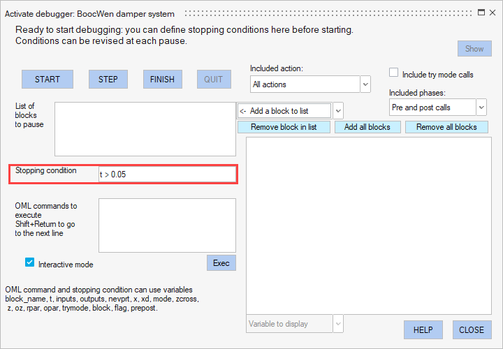

OML stopping condition
You can define pause conditions based on an OML expression. Write the OML expression in the Stopping condition field in the Activate debugger dialog box. A pause occurs if the OML expression evaluates to true or 1.
The stopping condition is tested if the other conditions (block name, flag, phase, and try mode) do not filter out the call.
The stopping condition can contain any of the variables in the table below. The variables that can be used are shown at the bottom of the dialog box.
