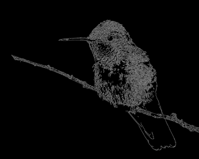

Example
Detect the edges with the Canny algorithm:
handle = imreadcv('bird3.jpg', 0);
R = cannycv(handle, 50, 100);
Figure 1. Input image
Figure 2. Output image

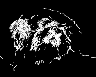

Detect the edges and dilate the output:
imgoriginal = imreadcv('Dog.jpg',1);
figure(1);
imshowcv(imgoriginal);
%Conver the image to gray scale
img = cvtcolorcv(imgoriginal, 6);
edges = cannycv(img, 70, 180);
dilatededges = dilatecv(edges, []);
figure(2);
imshowcv(erodededges);
Figure 3. Input image
Figure 4. Output image
