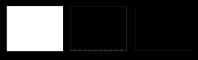

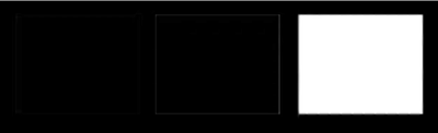

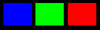

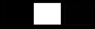

Merge the RGB channels and create one merged image:
%Read image
img = imreadcv('RGBchannels.jpg',1);
[blue, green, red] = splitcv(img);
figure(1);
imshowcv(blue);
figure(2);
imshowcv(red);
figure(3);
imshowcv(green);
merged = mergecv(red,green,blue);
figure(4);
imshowcv(merged);
Figure 3. Blue channel
Figure 4. Red channel
Figure 5. Green channel
Figure 6. Merged image
