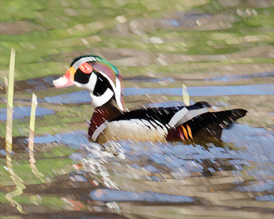

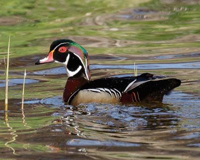

Dilates the given image:
handle = imreadcv('bird2.jpg');
R = morphologyexcv(handle, 1, eye(20));
Figure 1. Input image
Figure 2. Output image
