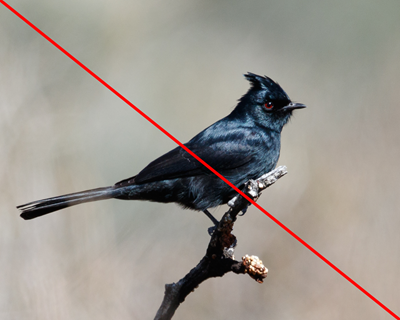

Example
Draw a red line with thickness 12 across the diagonal on an image :
handle = imreadcv('bird4.jpg');
handlesz = imsizecv(handle);
linecv(handle, [0 0], [handlesz(2) handlesz(1)], [255 0 0], 12);
Figure 1. Input image
Figure 2. Output image
