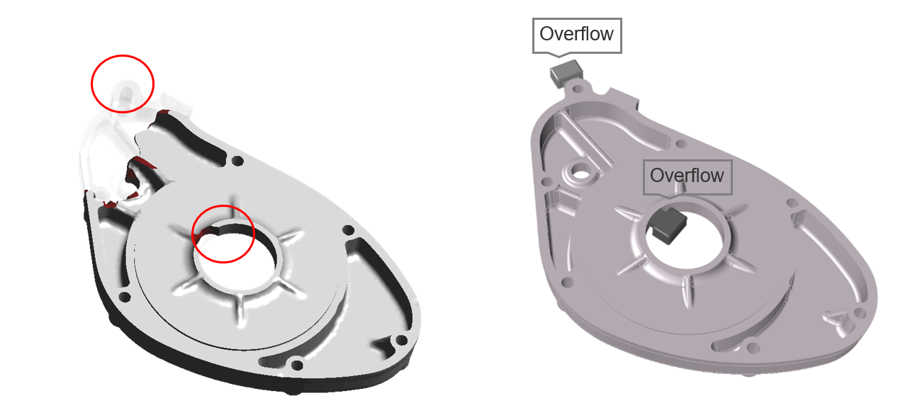

Overflows are cavities in the die that act as vents for air to escape and as traps for excess metal flow.
![](../../../images/figures/cast/overflow_concept.png)
Figure 1. Example of Two Overflow Cavities
