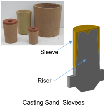

A sleeve is a sand component that is placed around a riser.
It is used to slow the cooling of the riser or decrease its size. It can be exothermic
(releases heat) or isothermic (retains heat). Figure 1. Example of a Sleeve Position in Relation to a Riser
