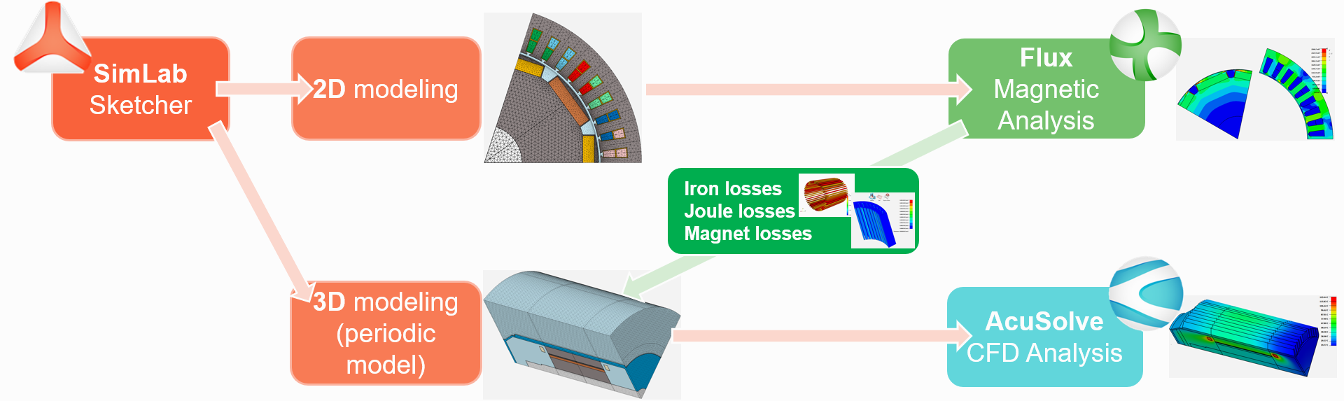

After the 2D transient magnetic is finished, the power loss results (both Joule losses and iron losses), can be used for further CFD analysis. All loss results obtained with Flux will be converted to Heat Sources for AcuSolve. The EM-CFD coupling workflow is shown below:

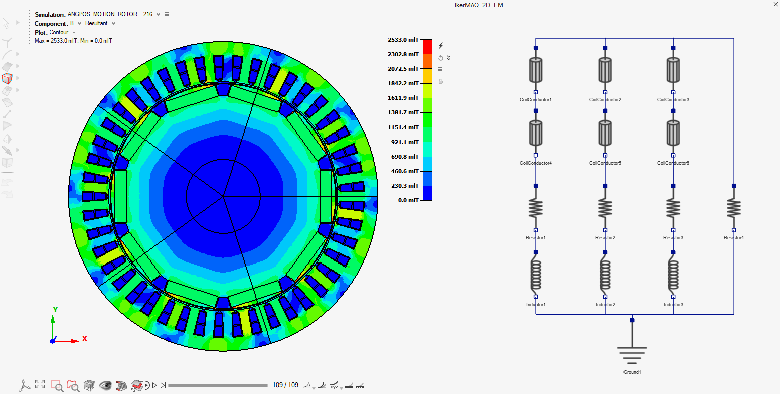

Analysis 1: 2D transient magnetic analysis
The objective is to calculate electromagnetic torque and other electrical parameters (phase voltages, phase currents, power, losses, etc.) for different rotor positions under transient analysis. In this case, the transient magnetic application is used and coupled with an external three-phase circuit (created by the Circuit Designer) while varying rotor position.

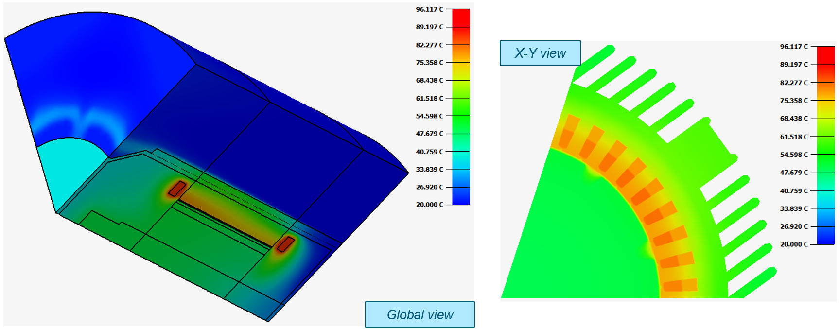

Analysis 2: Steady-state CFD analysis
Once the PMSM is electromagnetically computed, the second step is to analyze its thermal characteristics. In Flux, the most common way is to export the copper loss / iron loss information from the transient magnetic analysis and run the CFD analysis with AcuSolve. The following temperature distribution figure provides a primary analysis of the thermal characteristic inside the motor. Furthermore, all the results are compared to the measurement.
