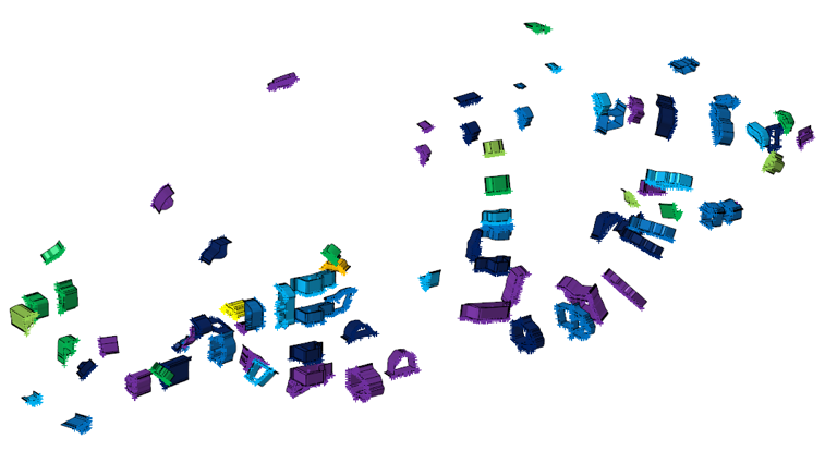

Figure 2. Sections from Section Library

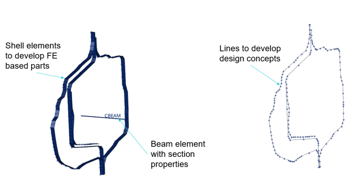

Each section in the section library contains:
- A Beam element with a section property
 - 2D elements showing the shape of the section. The 2D element section is welded at the flanges.
 - Geometric lines representing the shape of the section that can be used for concept modeling. The geometric sections are not auto-welded at the flanges.

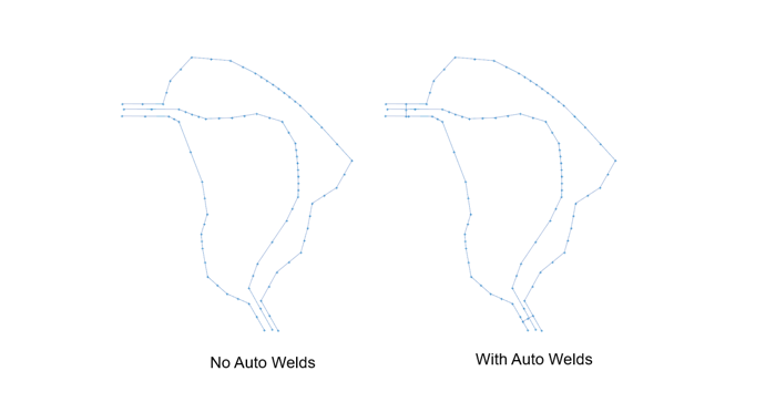

Figure 3. Sample Section
Figure 4. Beam Section with Auto Welds

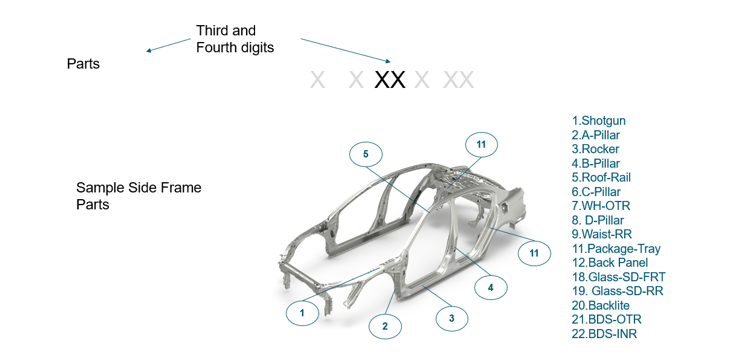

- 1: If the section belongs to the Side Frame assembly

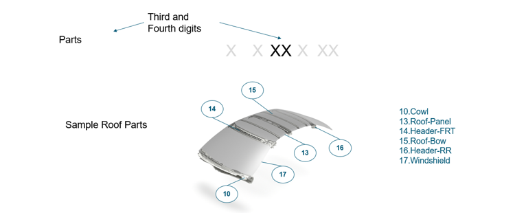

 - 2: If the section belongs to the Roof assembly

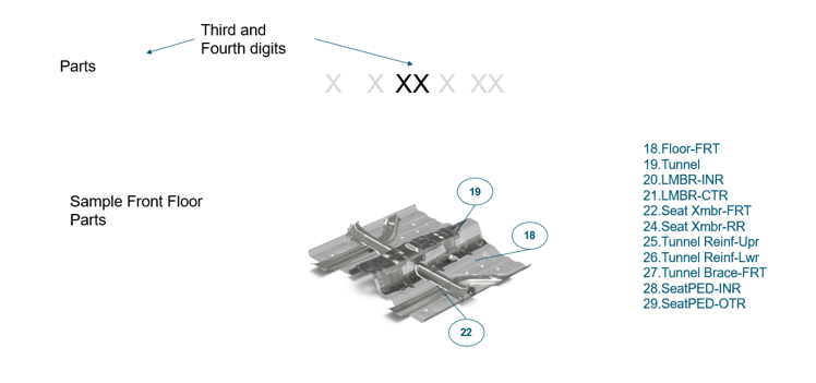

 - 4: If the section belongs to the Front Floor assembly

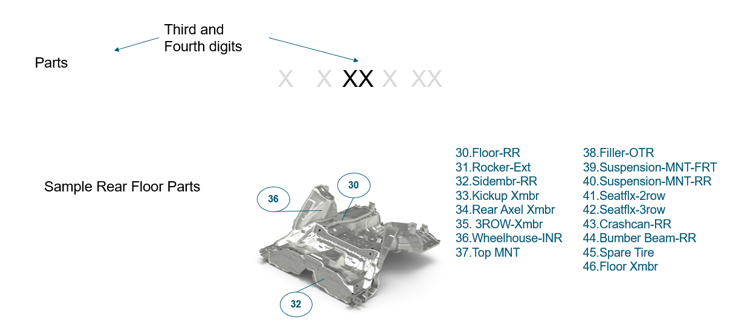

 - 5: If the section belongs to the Rear Floor assembly

- The third and fourth digits correspond to parts from the assembly. Each assembly has a number of parts; for example, the list of sample parts goes to 11 in Figure 7.

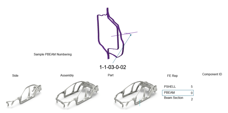

 - The fifth digit corresponds to the FE representation of the section. It can
                        take values of 0, 2, or 5.
- 0: If the FE representation is PBEAM
 - 2: If the FE representation is Beam Section
 - 5: If the FE representation is PSHELL
 - The sixth and seventh digits correspond to the component number.
An example of the numbering scheme implemented on the left-hand side rocker/sill section can be seen in Figure 6
Figure 6. Numbering Scheme Example
Figure 7. Sample Side Frame Parts

Figure 9. Sample Front Floor Parts
Figure 10. Sample Rear Floor Parts
Figure 11. Sample Roof Parts
