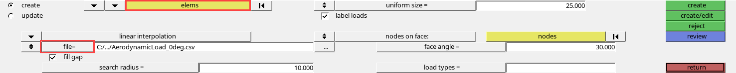

Click the elems button. Select by
collector from the list.
Figure 14.Figure 15.
From the component collector list, click Fore
Canard. Click the select button
to return to the pressures panel.
Figure 16.
Click the ellipse button to browse for a
file.
Figure 17..
In the Open dialog, browse your
<working directory> and select
AerodynamicLoad_0deg.csv. Then click
Open.
Figure 18.
Click create to create pressure loads for the
0deg position.
Figure 19.Figure 20.Note: The pressure load on each element is obtained by a linear interpolation of pressure values with respect to its location.

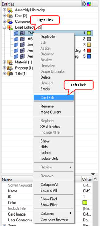

Specify load sets for CMS method.
Three load cases modeled in previous step represent nodal forces. These nodal forces are transformed as modal forces using CMS method. In this step you modify the existing CMSMETH card image to include three load sets.
- In the Entities browser, right-click on the CMS load collector.
In the context menu, click Card
Edit.
Figure 21.Figure 22.

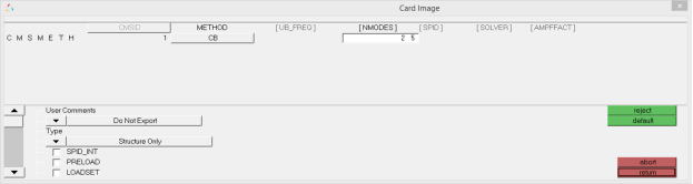

Specify load sets for CMSMETH.
- In the Card Image dialog, activate the LOADSET checkbox.
Specify the CMS_LOADSET_LSID_NUM value as
3.
Figure 23.
Double-click LSID(1).
Figure 24.
From the load collectors list, click
AerodynamicLoad_0deg. Click the
return button to go back to the CMS card
image.
Figure 25.Figure 26.
- Use steps 8.c and 8.d to specify AerodynamicLoad_Negative10deg for LSID(2) and AerodynamicLoad_Positive10deg for LSID(3).
- Click Return.

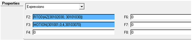

- A motion on the Piston with an expression 0.025*SIN(2*PI*TIME) to extend
and retract the piston by 25mm at 1 Hz. This piston motion varies the
fore canard angular position between -9.619 deg to +9.984 deg. Figure 35.
- An expression type Output request to measure the “ForeCanard angular
position” and “Piston force along its axis”. The Fore canard angular
position is measured from the
RevJnt_TorqueArm_Gnd joint rotation
angle using the expression
RTOD({j4.AZ}). The Piston force is
measured from the Piston Motion using the expression
MOTION({mot0.tr∈g},{0},{4},{j2.i.tr∈g}).

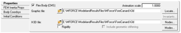

Switch the rigid fore canard to a flexible body.
- From the Project Browser, select the Fore Canard body.
In the Body panel, activate the Flex Body(CMS)
check box.
Figure 39.
Browse your <working directory> and specify
flex_ForeCanard.h3d for the Graphic and H3D
files.
Figure 40.

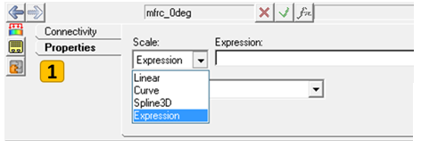

Configure the ModalForce panel.
In the Connectivity tab, specify Fore Canard for
the Flexbody.
Figure 45.
From the Properties tab, specify the Scale type as
Expression, the LoadCaseID as
3, and the Expression as
STEP(VARVAL({svang.tr∈g}),-10,0,0,1)⋅STEP(VARVAL({svang.tr∈g}),0,1,10,0).
Figure 46.Figure 47.Figure 48.Figure 49.Figure 50.
