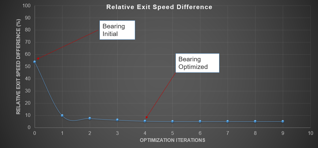

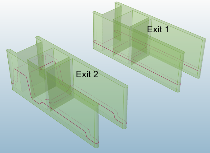

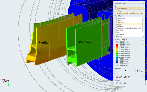

Bearing length optimization is performed to ensure the velocity of an extruding profile at the exit is uniform. Before setting up for bearing optimization, the standard model setup should be fully completed or ready for performing a steady-state analysis.
Review Flow Simulation Results
Consider Grouping Bearing Lines

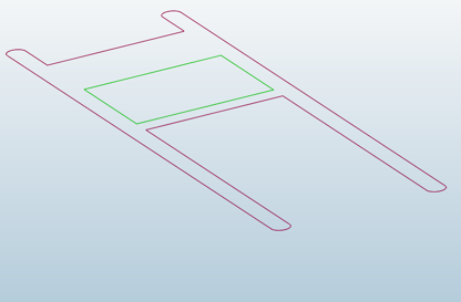

Load Model

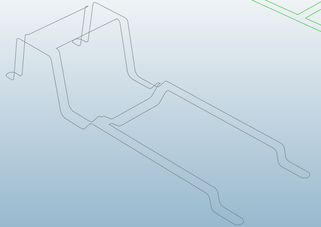

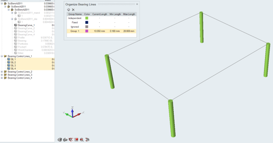

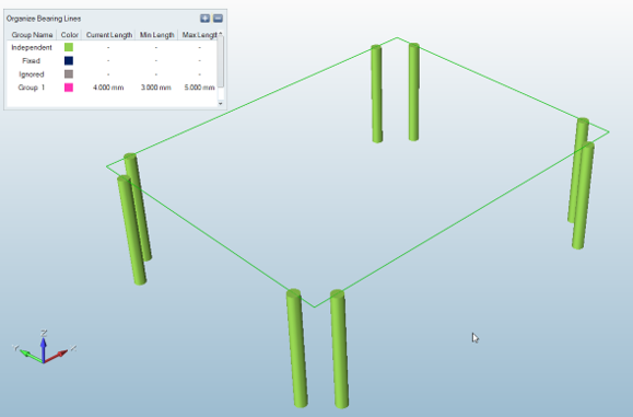

Select Bearing Curve

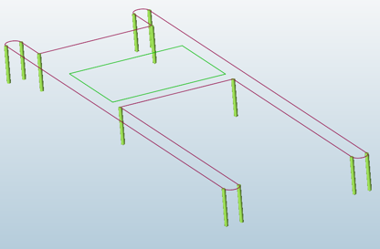

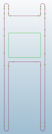

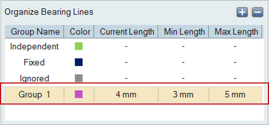

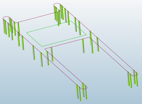

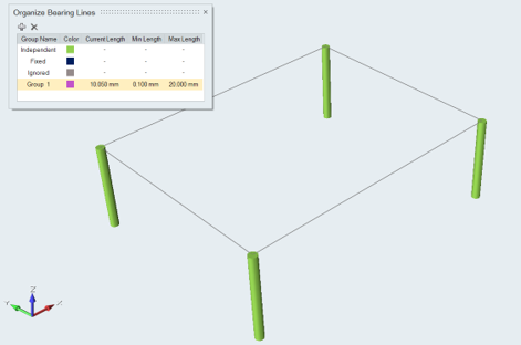

Add Extra Bearing Control Lines

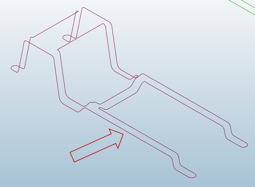

Group Bearing Lines

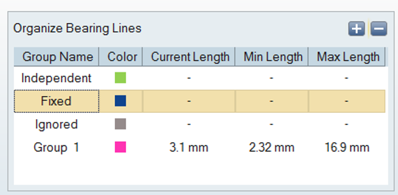

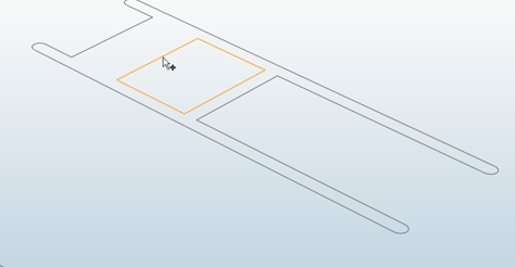

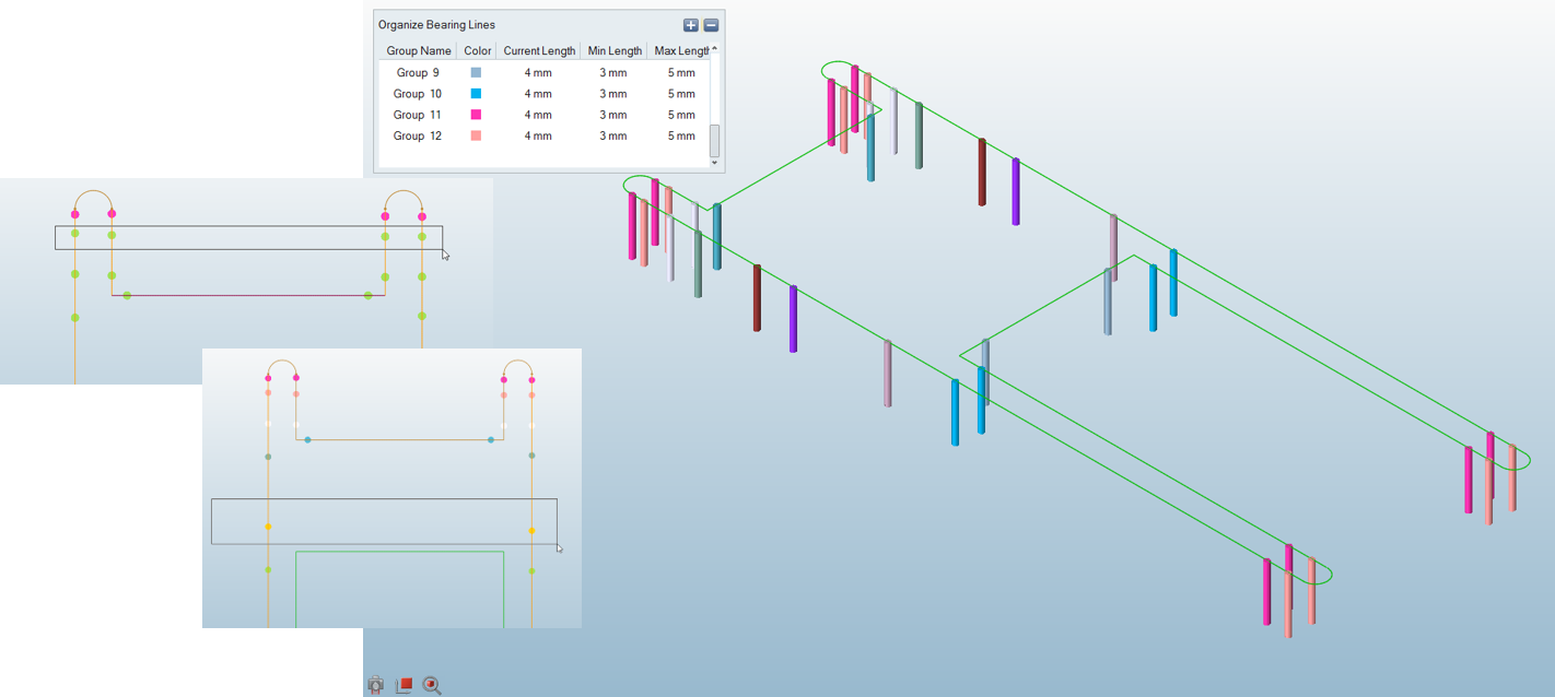

Select Next Bearing Curve

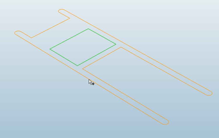

Add Next Bearing Control Lines
Group Next Bearing Lines

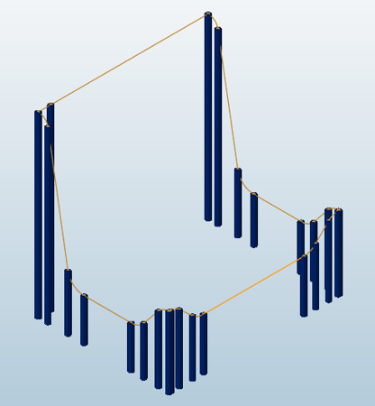

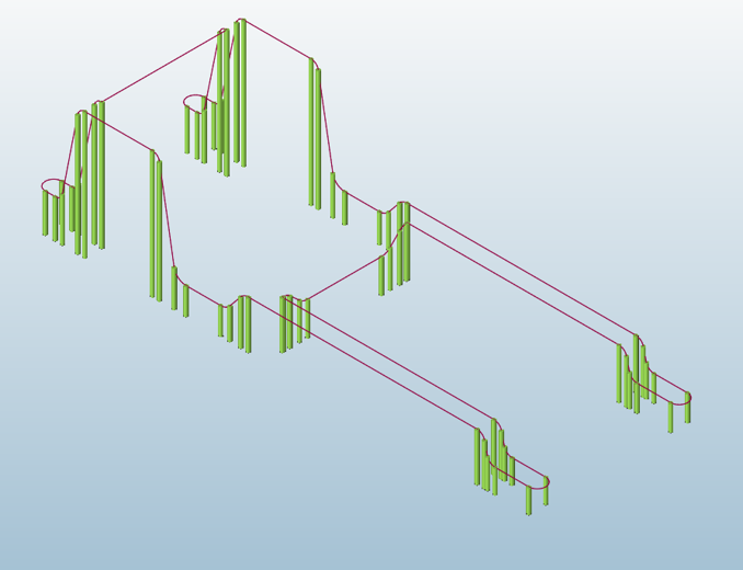

Optimize BearingCurve_2
Optimize BearingCurve_3
We are going to continue to group all of the optimized bearing lines as Fixed.

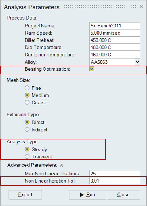

Specify Process Parameters and Simulate
| Status after submitting the job |
| Status after meshing is completed |
| Status when job is running in the solver |

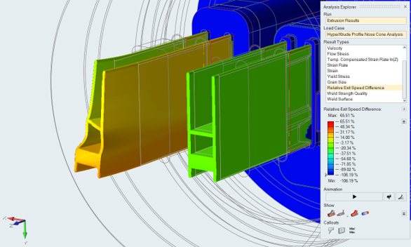

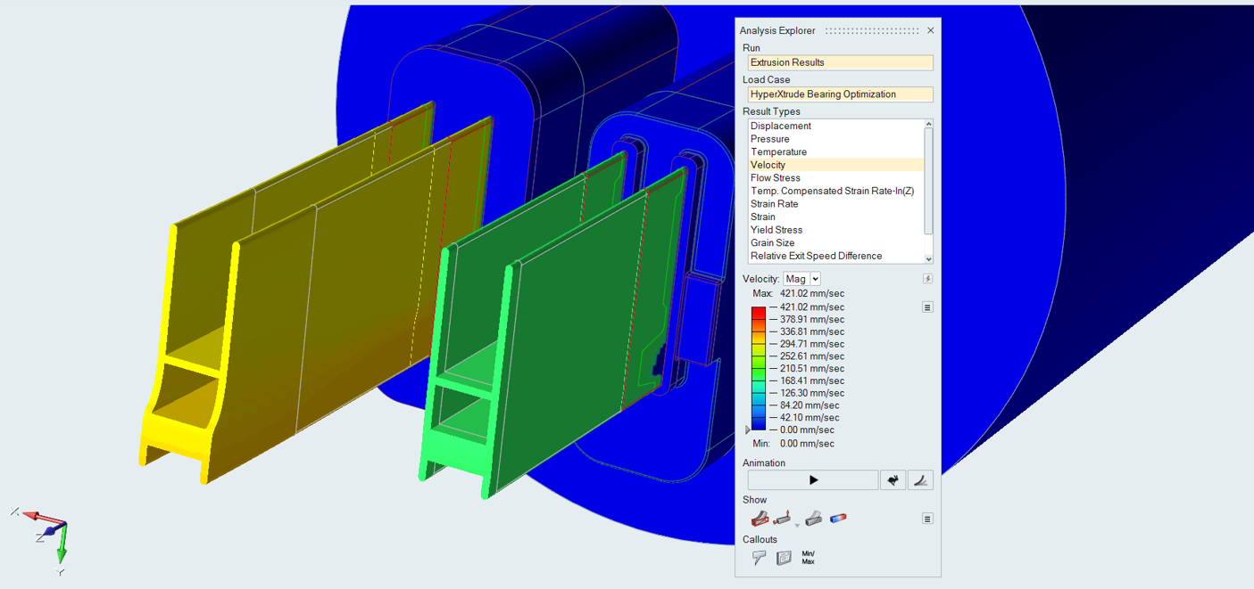

View Simulation Results
Figure 1. Bearing Optimization - 0th Iteration

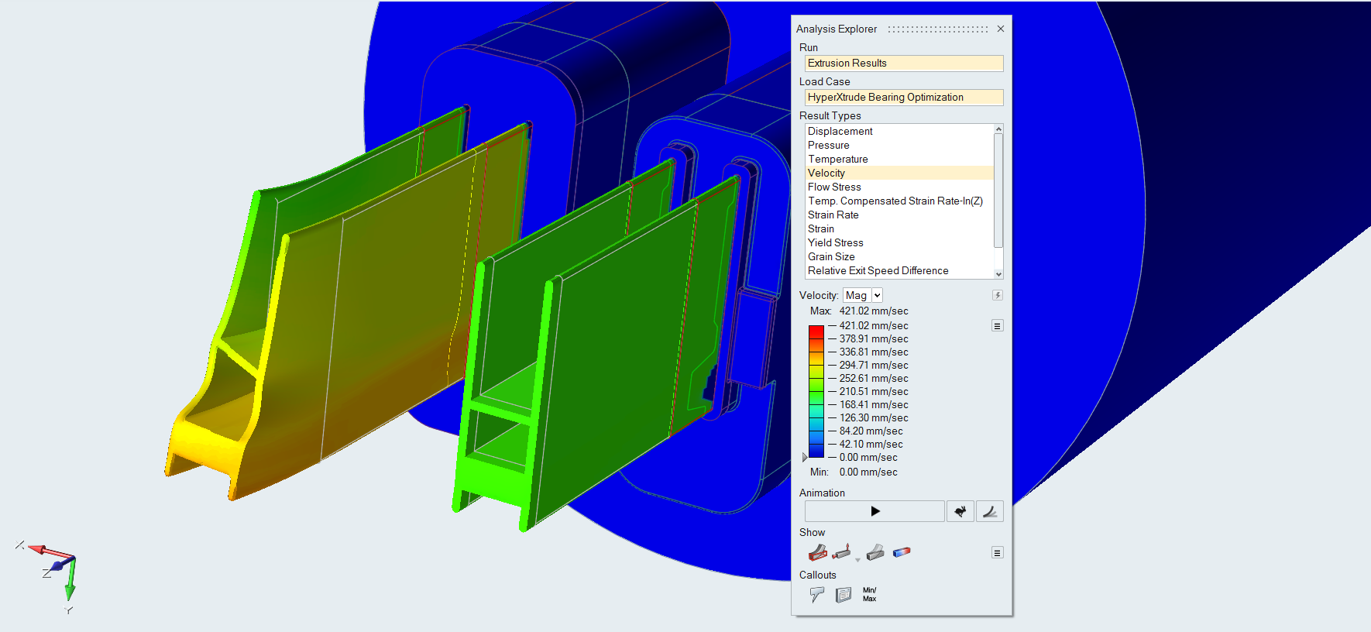

Figure 2. Bearing Optimization - 3rd Iteration
to add a new group, and select lines to be added to
this new
