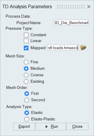

- By mapping loads from a .hmascii file written by HyperXtrude while performing the flow analysis

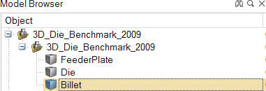

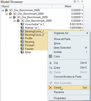

Delete Workpiece Components
This model contains two tool components, the feeder plate and die plate, as well as workpiece components that are not required for tool deflection analysis. Those components should be deleted before proceeding.

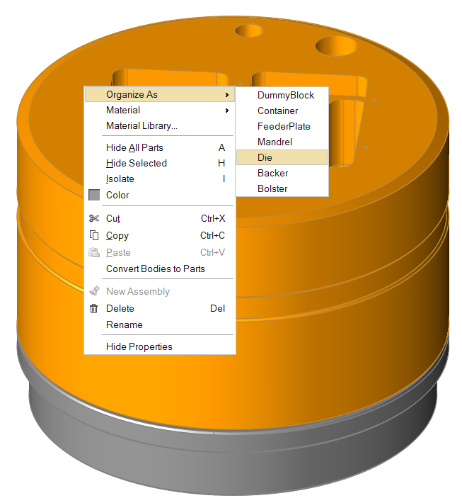

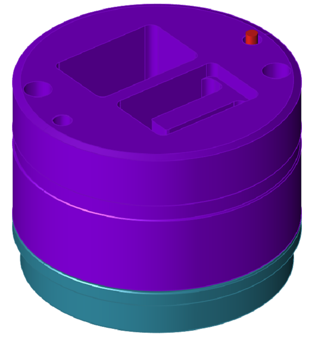

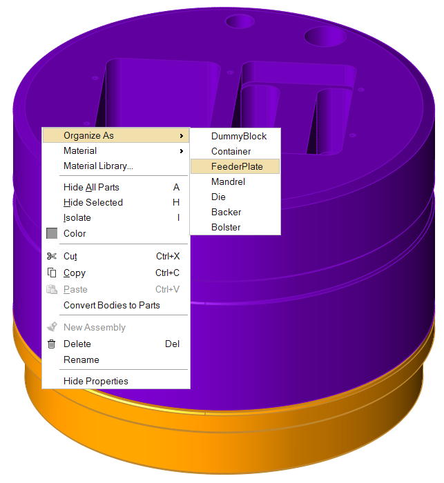

Organize Tool Components
This model contains two tool components, the feeder plate and die plate, which need to be organized.

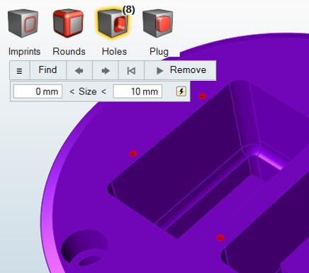

Simplify Geometry
The Simplify tools can be used to clean up problem areas in the geometry before running an analysis. They are used to delete extraneous lines, surfaces, and other components in the model and to remove unnecessary features such as holes used for instrumentation. This simplifies meshing and reduces the mesh size.

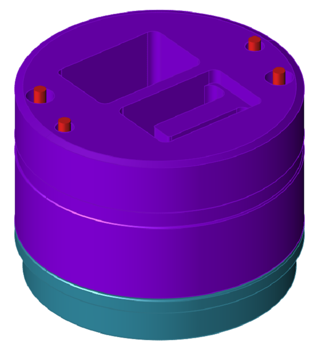

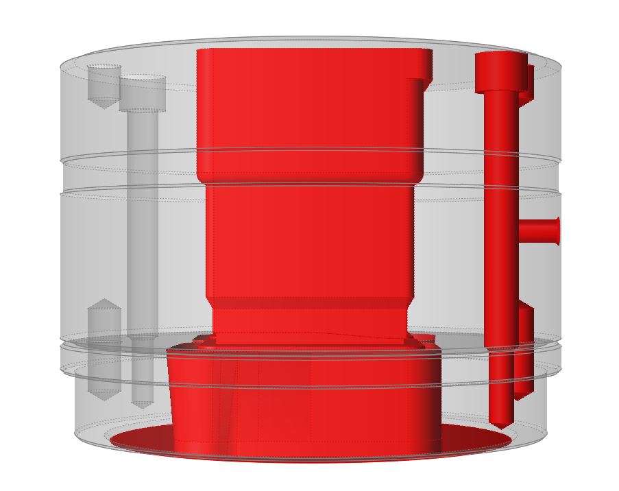

Create Load Faces
Create load faces where the material touches the tool geometry.
Workpiece material flowing inside the die exerts a load on tool surfaces and faces which are common between the workpiece and tool bodies. These are called load faces. Surfaces such as pin holes and relief regions are not in contact with the workpiece and should not be part of the load faces.

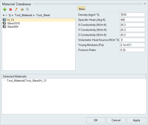

Select the Material
Specify Process Parameters and Simulate

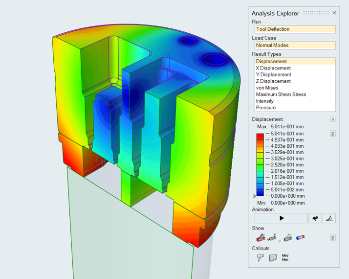

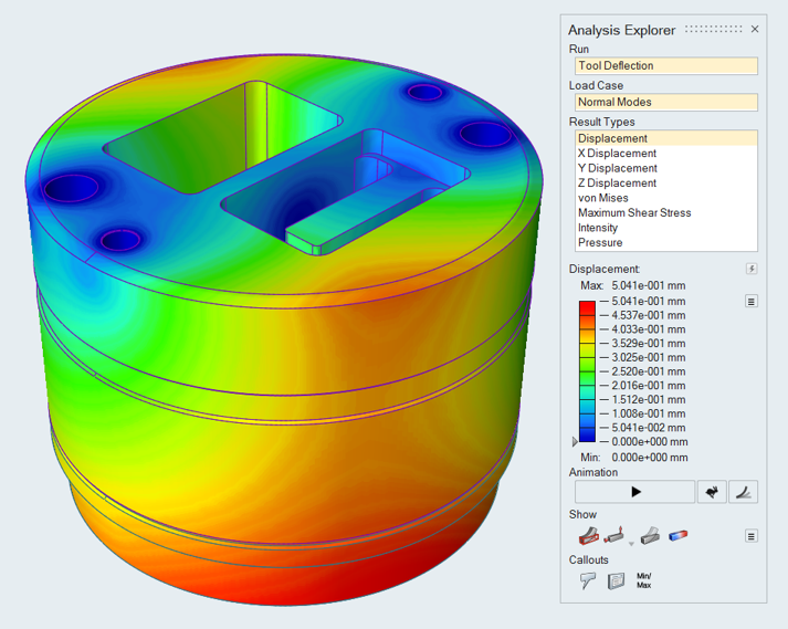

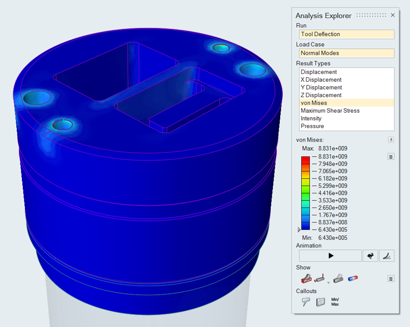

View Simulation Results
