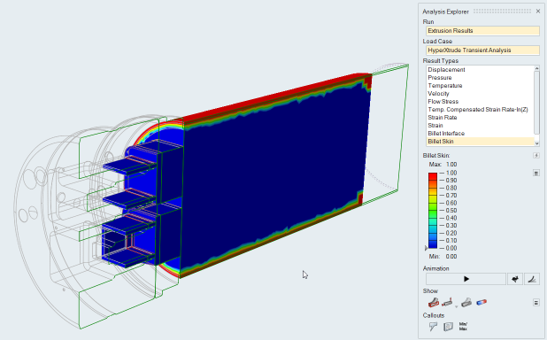

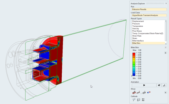

In Inspire Extrude, skin tracking analysis can be set up as a transient moving boundary analysis where the the movement of the dummy block and billet are simulated.

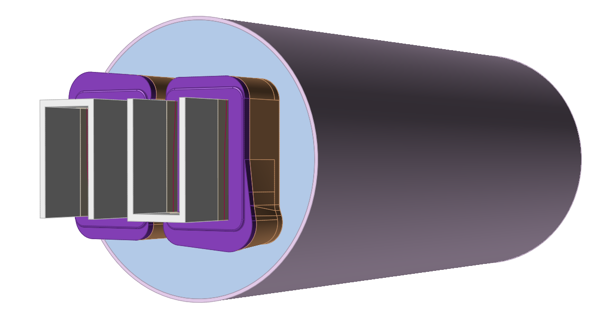

Create the Billet
We will specify the geometry to create the billet.

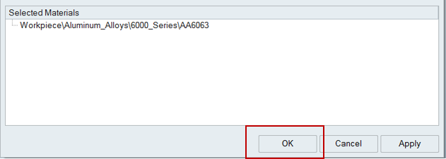

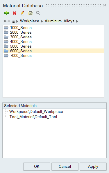

Select the Material

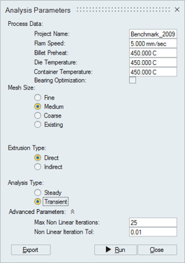

Specify Process Parameters and Simulate

The goal of post-processing is to understand the performance of the die. This is accomplished by studying the material flow and heat transfer in the model in HV. Before doing the detailed post-processing in HV, inspect the OUT file to get a quick overview of the results.

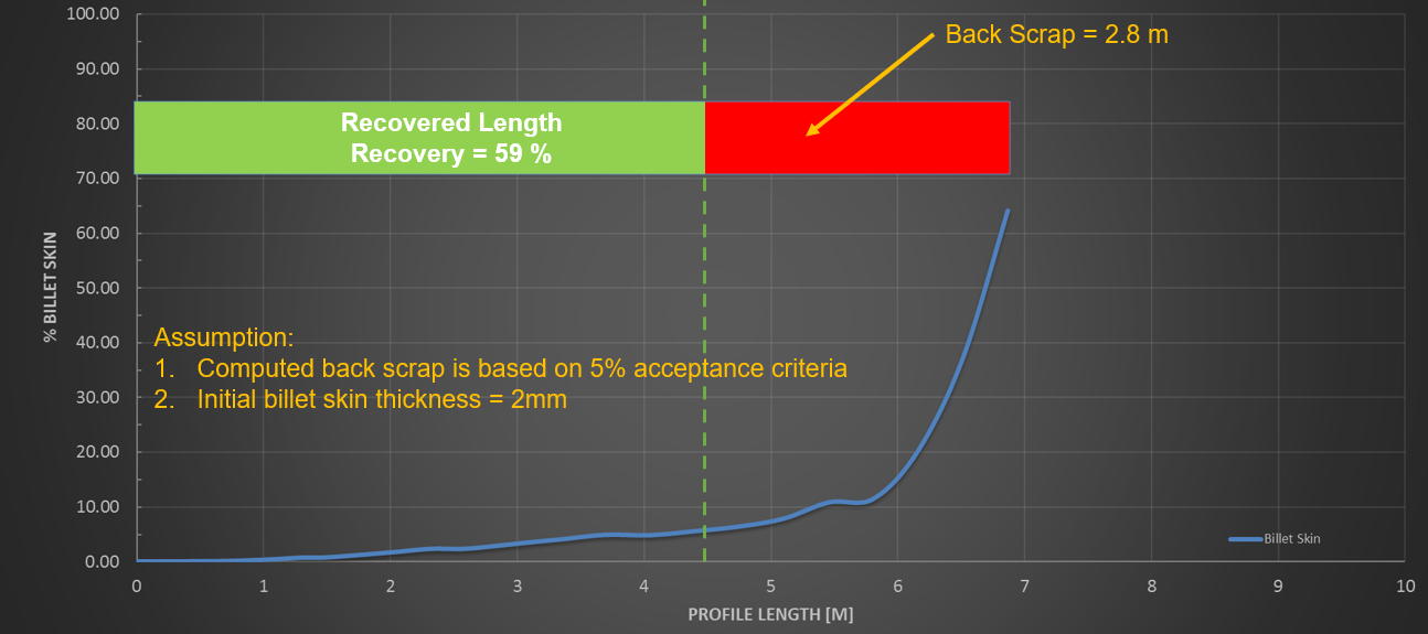

Analyze the Profile3D_volume.txt File

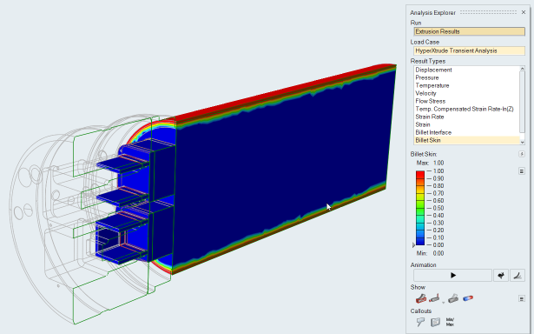

View Simulation Results
