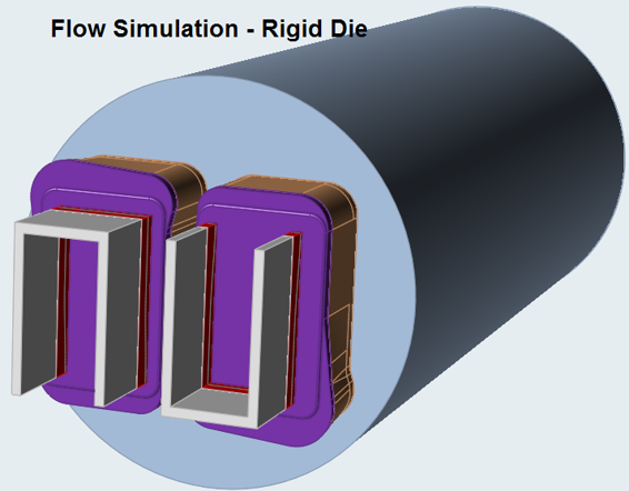

Organize Tool Components
This model contains two tool components, the feeder plate and die plate, which need to be organized.

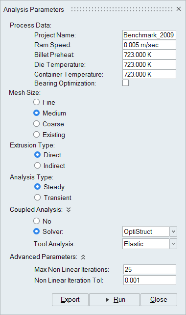

Specify Process Parameters and Simulate

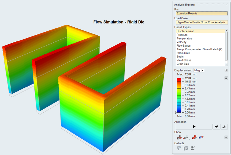

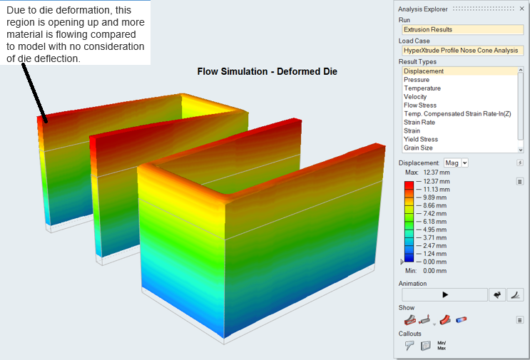

View Simulation Results
