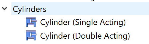

Quick Guide for Cylinder Component Creation in the GUI
There are two Cylinder subtypes under “Compressible Gas Elements” and “Incompressible Liquid Elements” sections in Flow Simulator.

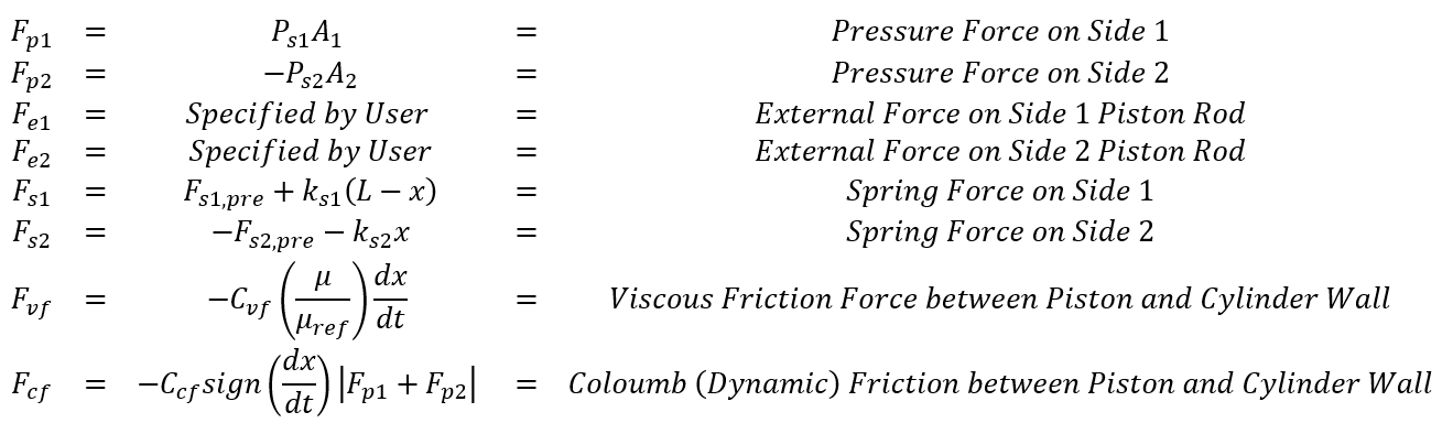

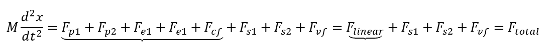

Piston-Rod Force Variable Definitions

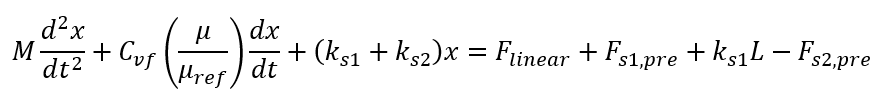

Force Balance Equation (Newton’s 2nd Law)
The Force Balance Equation can be re-written as a 2nd Order linear ODE

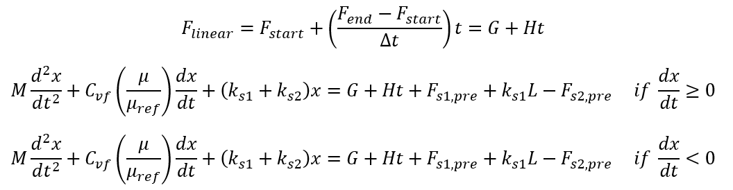

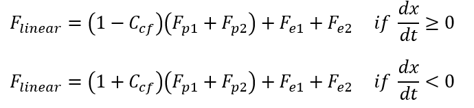

There are two complications.
- The Coulomb (Dynamic) Friction term is either positive or negative depending on
direction of piston motion. This means the governing ODE of piston motion needs
to be split into two parts, one for left-to-right motion and the other for
right-to-left motion. In both cases, the initial position and velocity are the
initial conditions.
- The total pressure force and external force () is changing within each timestep.
Floinhance assumes linear variation within each timestep, which is
2nd order accurate, and helps when you want to take relatively
large fluid timesteps. However, it should be noted that you can always get
achieve greater accuracy by taking smaller fluid timesteps.

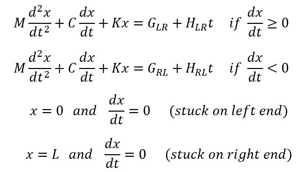

The governing ODE can be split into four distinct ODE regimes by introducing
and parameters. (LR signifies left-to-right
motion and RL is right-to-left motion.)

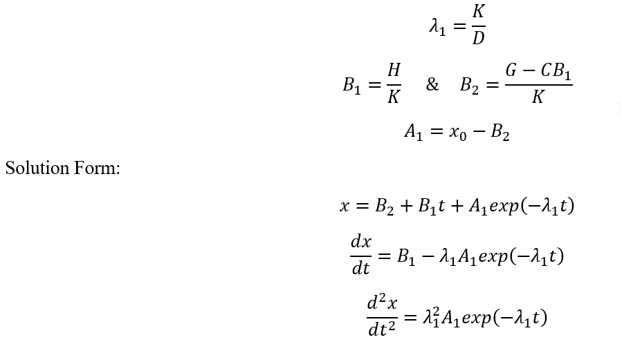

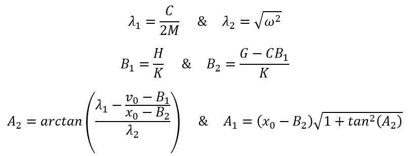

Depending on the ODE coefficients of the two non-trivial ODEs, the ODE solution can follow one of eight different equation forms.

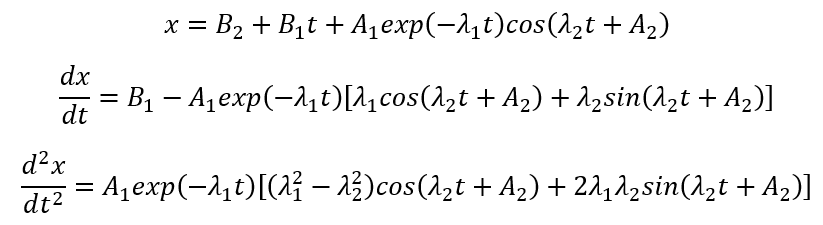

Under-damped when ![]()
Solution Parameters based on ODE Coefficients and Initial Conditions:
Solution Form:

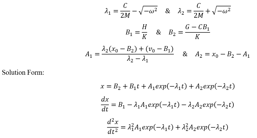

Over-damped when ![]()

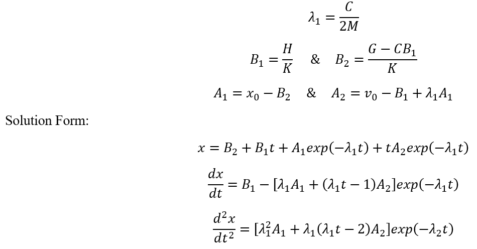

Critically Damped when ![]()

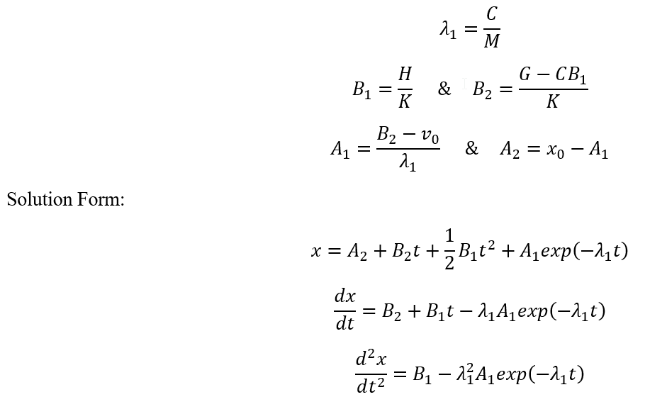

Spring-less when K=0
Spring-less & Friction-less when K=0 & C=0

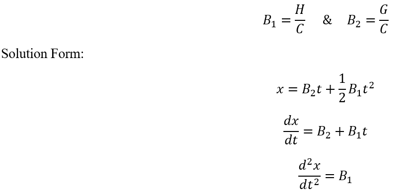

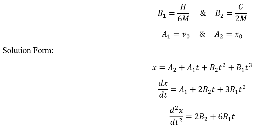

Mass-less when M=0

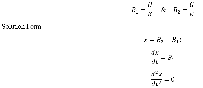

Mass-less & Friction-less when M=0 & C=0
Mass-less & Spring-less when M=0 and K=0

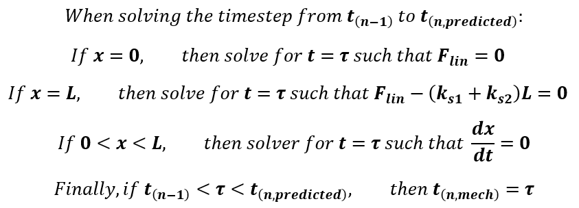

Adaptive Time-stepping
Detecting changes in four ODE regimes adaptively and adjusting the piston motion timestep and/or fluid timestep is critical to accurate results.
If the “Mechanical Only” adaptive option is chosen, then
is equal to
. The piston-cylinder solver will shorten the
piston motion ODE interval. A second (or sometimes more) piston motion solution
intervals will be required to reach
. Therefore, there will be piecewise piston
motion solution in on the interval from
. However, the linearly varying force
assumption, which is usually due to time-varying pressures, still applies on the
interval from
. This means you a not resolving the fluid
pressure changes at the shorter timestep.
If the “Coarse” adaptive option is chosen, then
is set equal to
, so the fluid timestep is shortened as well.
This achieves greater accuracy.
The “Fine” adaptive option is like “Coarse”, expect with an addition constraint. If there is a spring, then there is a natural oscillation period based on the spring stiffness and piston-rod mass. The timestep will not be allowed to go higher than 1/N of the natural oscillation period. The default N is 12. You can change this input in the Advanced Options menu. This option should be used for Cylinder components with high coupling sensitivity to the fluid model – and where oscillations of the piston must be captured to correctly model the physical behavior of the system.
Finally, the “Off” option does not shorten either mechanical or fluid timestep. However, it does use a numerical trick to prevent spurious oscillations that occur when you require the piston to leave the end at the “wrong time”. It uses a smoothing option, described in detail in the following section, but only for the time-steps where the piston becomes unstuck.

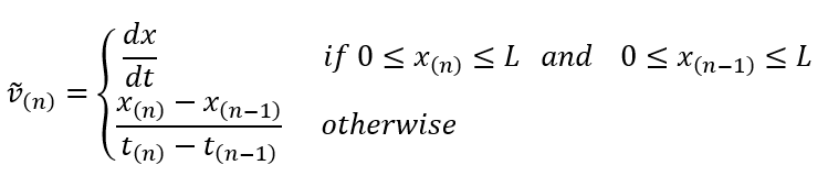

To couple the piston motion with the fluid solver, the mass flow rate at the piston ports must be calculated. Here we define as the rate of mass entering the cylinder through the port.
The velocity
term needs special treatment that is
analogous to unwinding in CFD. This helps to achieve a stable and accurate
solution.
In other words, Flow Simulator uses the exact solution for velocity to calculate mass flow rate when the piston is not near the end positions. However, when the piston becomes stuck or unstuck from the end position, Flow Simulator uses a conservative differencing formula. This makes sure the rest of fluid circuit experiences the correct amount of mass release or mass removal by the cylinder.
