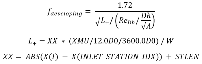

For a Tube Element, Laminar Friction Inlets effects can be accounted. Friction coefficient for hydrodynamically developing flow with “Muzychka Yovanovich Laminar Inlet Effects” can be calculated as:
The friction coefficient for combining developing flow and fully developed flow can be calculated as:

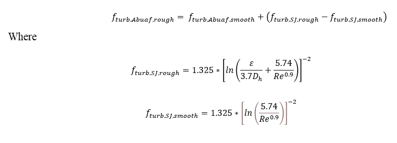

- Abuaf Friction Relation
- The Abuaf friction relation should generally be used for smooth walled tubes.
(8) In Flow Simulator, you have the option to use the Abuaf friction relation together with wall roughness. The following adjustment equation is used:

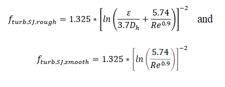

(9) - Swamee-Jain Approximation of the Colebrook-White Equation (Moody Diagram)
(10) The Darcy and Fanning type frictions are calculated as:(11) - User-specified Friction Factor
