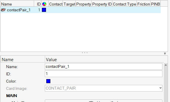

  2. In the second pane of the Contact Browser, right-click and select Create > Contact Pair from the context menu.
    HyperMesh creates and opens a contact pair in the Entity Editor as indicated in Figure 4.
    Figure 4.

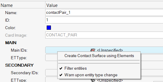

    1. In the Entity Editor, right-click on Main IDs and select Create Contact Surface using Elements from the context menu.
      Figure 6.

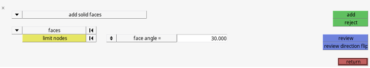

    2. In the panel area, set the first switch to add solid faces.
    3. Set the advanced selection switch to faces.
      Figure 7.

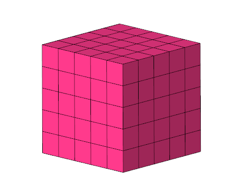

    4. Select the top faces of the cube as indicated in Figure 8.
      Figure 8.

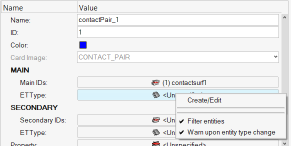

  4. Create and attach an Et Type to the contact surface.
    1. In theEntity Editor, under MAIN, right-click on ETType and select Create/Edit from the context menu.
      Figure 10.
    2. In the Create Sensors dialog, define the sensor.
      Note: By default, the Element Type is set to CONTA174.
      • Enable KeyOpt12.
      • Select 0-Standard from the list.
    3. Close the dialog.
      Figure 11.

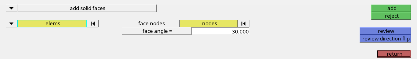

    3. Set the advanced selection switch to elems.
      Figure 13.

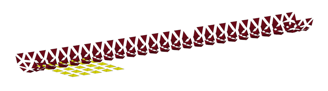

    6. Click add.
      Surfaces are created on selected elements.
      Figure 16.

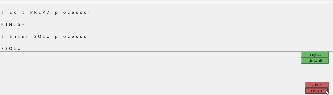

Add /SOLU and SOLVE in the Control Cards
In this step, you will add the following Control Cards.
Restriction: Only complete this step if your model needs to be solved in ANSYS.
  1. In the panel area, click Analysis > Control Cards.
    The Control Cards panel opens.
  2. Click /SOLU to exit the PREP7 preprocessor and enter the SOLU preprocessor.
    Figure 19.
  3. Click return.
