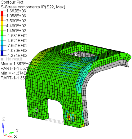

Apply a Contour of the Scalar Stress to the Shell Elements in the Left Window
- Click on the left window in the graphics area to make this window the active window.
Click the Contour panel button
on the Result toolbar to enter the Contour panel.

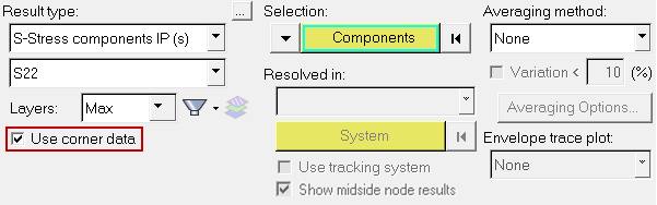

For Result type, select S – Stress components IP (s).
This is the scalar stress and it is in a local coordinate system.
- Under S – Stress components IP (s) click on the drop-down menu and select S22.
Activate the Use corner data option check box.
Figure 5. - Notice that the Components button under Selection is highlighted with a cyan box meaning that it is the current selection method. In the graphics area, click on the green component so that only this component is contoured. This component only contains shell elements.
Click Apply to contour the model.
Figure 6.

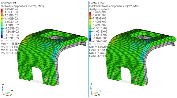

Apply a Contour of the Tensor Stress to the Shell Elements in the Right Window
- Click on the right window in the graphics area to make this window the active window.

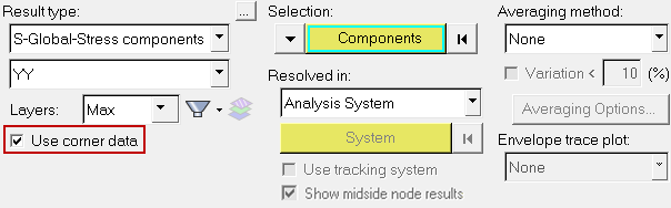

- For Result type, select S – Global Stress components IP (t).
- Under S – Global Stress components IP (t) click on the drop-down menu and select YY.
Figure 7. - Notice that the Components button under Selection: is highlighted with a cyan box meaning that it is the current selection method. In the graphics area, click on the green component so that only this component is contoured. This component only contains shell elements.
Figure 8. Note: The results are different between the scalar S22 and the tensor YY. One would expect that these two options would contour the same results (assuming that S22 corresponds to the Y direction). Remember that the scalar results are in a local coordinate system. For this analysis the local coordinate system has been defined as the following: the first axis is the global Y direction and the second axis is the global Z direction. Therefore, S22 actually corresponds to ZZ.

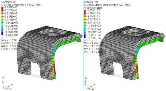

Update the Contour of the Tensor Stress in the Right Window
- For Result type, leave S – Global Stress components IP (t).
- Under S – Global Stress components IP (t), update the value from YY to ZZ.
Figure 9. Note: Now the results match. Remember, shell elemental results are the in the local coordinate system for scalar results and in the global coordinate system for tensor results.
