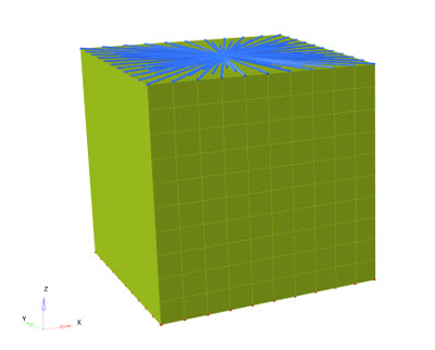

A cube (100mm*100mm*100mm) is modeled with solid elements.

A cube (100mm*100mm*100mm) modeled with solid elements (/PROP/SOLID) and foam material (/MAT/LAW70) is compressed or extended in the vertical direction.
The nodes of the cube top surface are defined in a rigid body (/RBODY) with a vertical imposed displacement defined with a smooth function (/FUNCT_SMOOTH).
The nodes of the cube lower surface are also defined in a rigid body and its main node is clamped using a boundary condition (/BCS).
