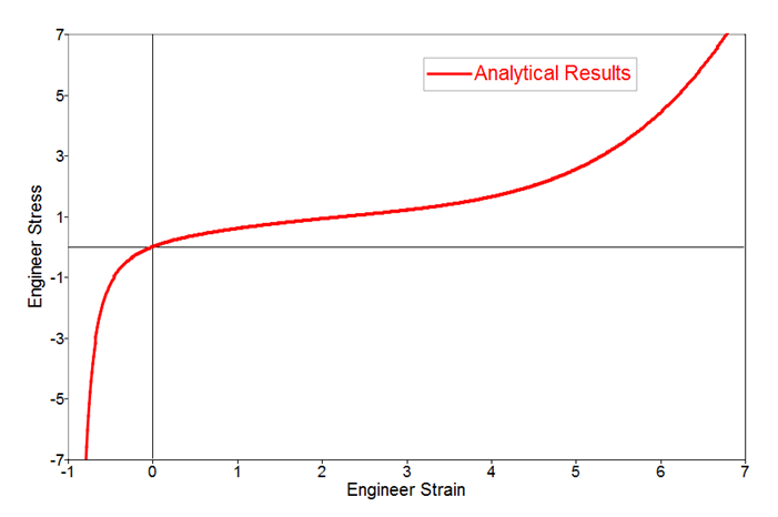

The Cauchy stress of Yeoh model is
computed as: (4)
In the uniaxial test, the Cauchy stress (true
stress) in principal direction 1 is: (5)
The engineer stress is:(6)
In this example, three material parameters are
defined below: (7)

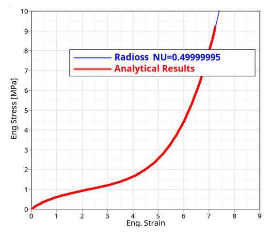

Compare the above results, then show the difference with analytical results
especially in high deformed area.
In order to match the incompressible hyperelastic analytical results, the Poisson’s
ratio needs to be defined as close to 0.5 as possible, but can not be simply defined
as , which will lead to infinite small time step in
numerical computation. In this example is used. It shows Radioss results are well matched with analytical results.
Since material incompressible is assumed in analytical calculation., Poisson’s ratio
closer to 0.5 is better, but the computation time will increase. Just one element
tension model from to run time is more than 20 times increased. In this
example, use ; therefore, set D1=0.003334.
