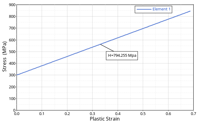

A tensile loading is applied to a cube with side lengths 25.4 mm. The bottom of the cube is fixed in the z-direction and an imposed velocity of 508 mm/s in the z direction is applied to the top of the block. The simulation was run to a final time of 0.05 seconds. A two elements per side mesh was studied.
The plastic hardening modulus, H, is used as the problem metric. In Radioss, the plastic hardening parameter, b, in /MAT/LAW2 (PLAS_JOHNS) material law is the same as the plastic hardening modulus, H.

The plastic hardening modulus is the slope of the stress versus plastic strain curve.
Conclusion
As shown in Figure 2, the hardening modulus from the simulation, H=794.225 Mpa, exactly matches the value input for “b” in /MAT/LAW2 (PLAS_JOHNS).
