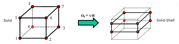

The elements HA8, HEPH and BRICK20 can be transformed to solid-shell elements by setting constant the normal stress through the thickness.
Figure 1. Solid versus Solid-Shell

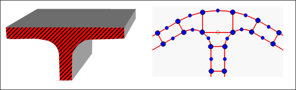

Figure 2. Application of Solid-Shell Elements
