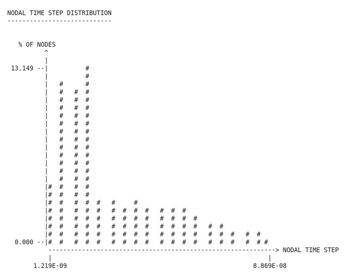

The time step of the initial model is output to the Starter output file. Whereas the time step of a running model can be output to the animation files.
Initial Model Time Step

Figure 2. Nodal Time Step Distribution Histogram
