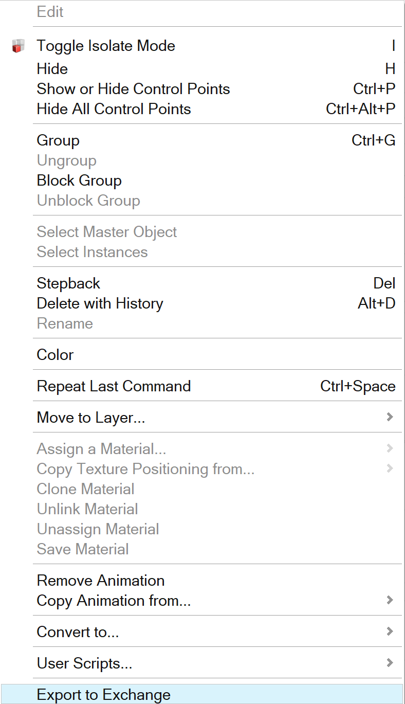

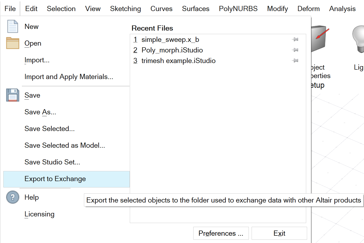

Export to Exchange
Export selected objects to a common file folder used to exchange data with other Altair products. For example, you can export a die design from Inspire Studio to Inspire Form to perform a stamping simulation. You can access this option from the right-click menu or the File menu.
