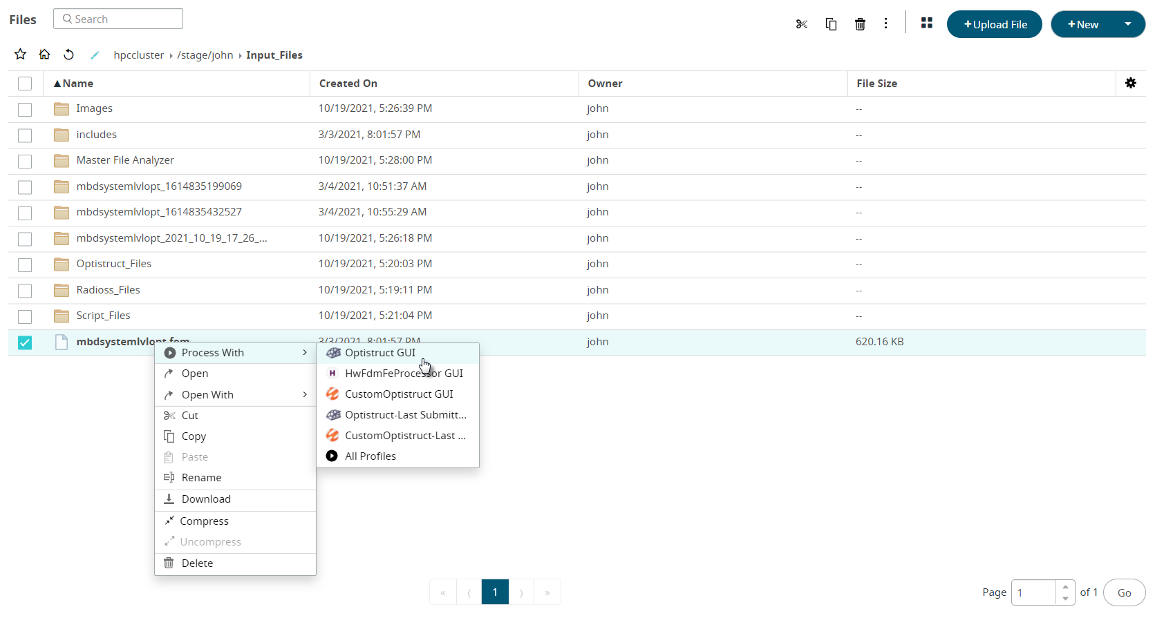

  3. Right-click the job input file.
  4. From the context menu, select Process With.
    Solvers or profiles suffixed with "GUI" indicate that additional information is required to submit the job. In this case, a Job Submission Form is displayed so that the information can be supplied.
    Tip: Select All Profiles to set a default solver or profile for the input file type (based on the file extension) or to force the solver's job submission form to be displayed so that it can be customized.
    A list of solvers and profiles specific to the file type of the job input file are displayed.
    Solvers and Job Profiles Specific to the Job Input File Type
    Figure: Solvers and Job Profiles Specific to the Job Input File Type
  5. Select a solver or job profile.
    If additional information is necessary to submit the job, then a job submission form is displayed. Otherwise, the job is instantly submitted.

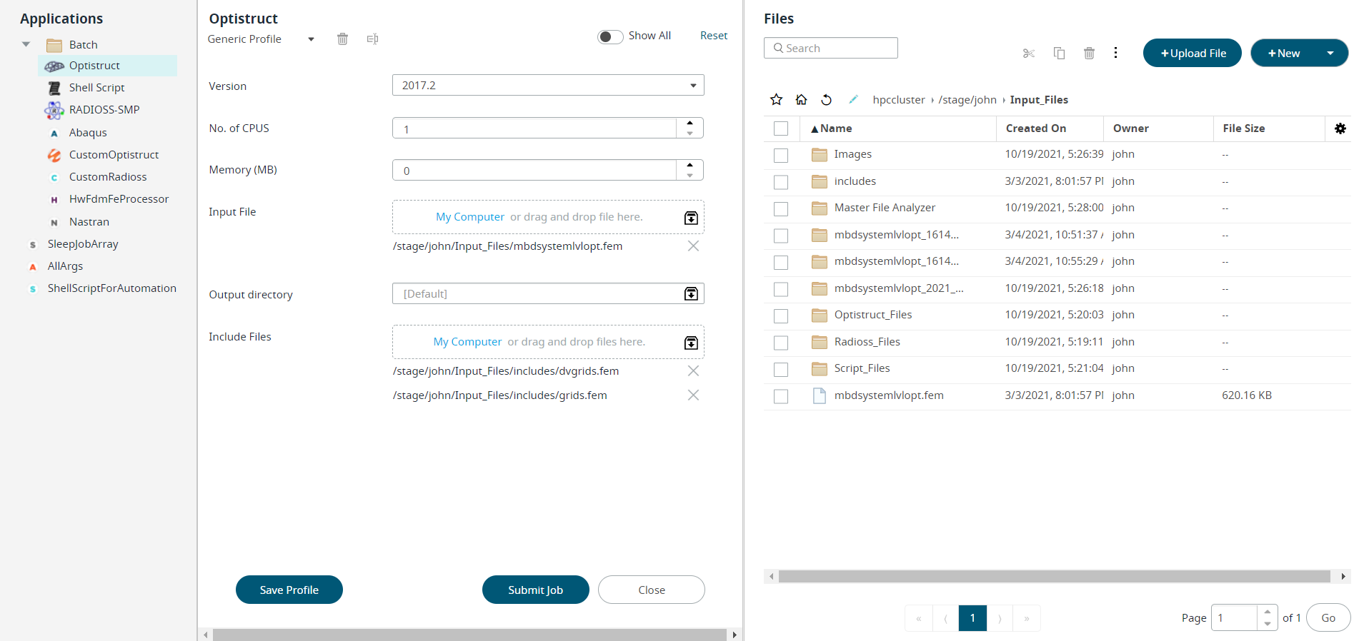

    A job submission form is displayed based on the selected solver or profile containing the required application arguments for the application. Values for these arguments must be entered for the job to be successfully submitted. Each application will have its own unique arguments.
    Job Submission Form
    Figure: Job Submission Form
  6. Fill in the required application arguments.
    1. Select the Server from the drop-down list.
      Note: The Server field will be displayed only if more than one Server Cluster is registered.
      The applications and profiles displayed on the left are those that are installed on the selected HPC complex.
    2. Select the version of the solver from the drop-down list.
    3. Enter the number of CPUs and Memory in MB required to run the job.
    4. Select an input file.
      If a Master File is selected as an input file, then the include files will be listed by default.
    5. Enter the Output Directory.
      By default, the output directory is created in the same location where the input files are located.
    Tip: Click Save Profile to create a customized profile with the pre-populated arguments.
  7. Click Submit Job.
    The job is submitted and a notification is displayed providing the status of the job.
    Tip: Click on the Job ID link provided in the notification to view the job status.
