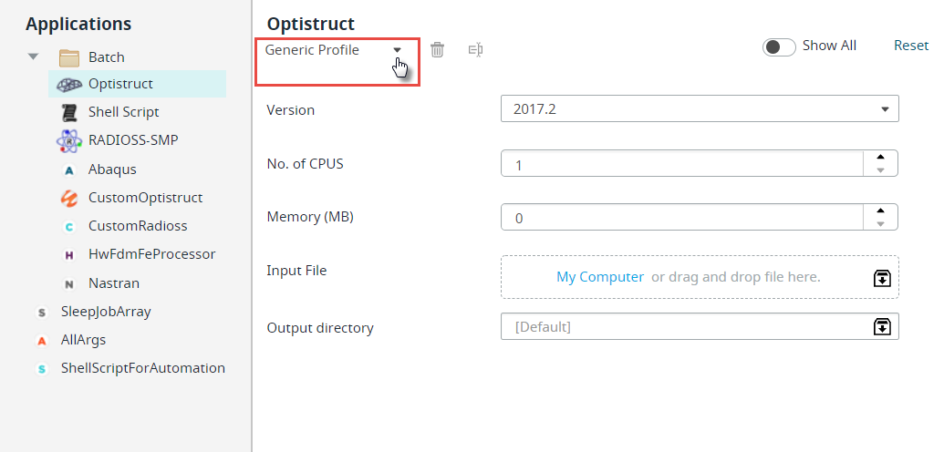

  3. Click next to Generic Profile to view the list of saved Profiles.
    Note: By default, only Generic Profile and Last Submitted profile will be listed if there are no saved profiles.
    The list of profiles is displayed.
    Figure: Saved Profiles List

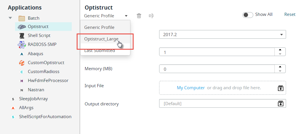

  4. Select the Profile from the drop-down list.
    The selected profile job submission form with the pre-populated argument is displayed.
    Figure: Profile Job Submission Form
    Note: The profile delete icon () and rename icon () will be enabled once you select a saved profile from the list.
