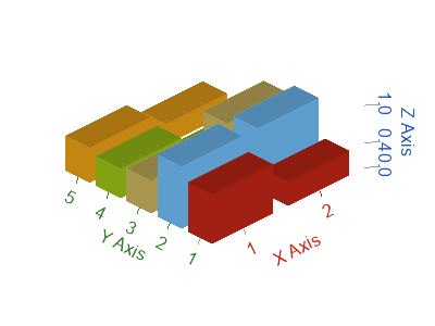

Simple bar3 example:
bar3(rand(5,3));
      Figure 1. Bar3 plot
Use the 'rowhandle' keyword to obtain a handle for each bar row:
clf;
h = bar3(rand(5,2),'rowhandle')
set(h(2), 'color',[115 194 255]);
set(h(2), 'zdata',[1 1]);
Figure 2. Obtain a handle for each bar row
