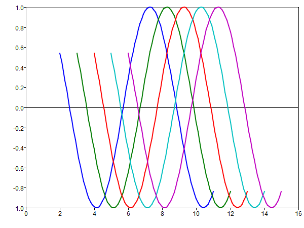

hold example on active axes.
figure;
axes;
hold('on');
x = 1:0.1:10;
for ii=1:5
  plot(ii+x, cos(x));
end
      Figure 1. Set hold 'on' on active axeshold example on axes.

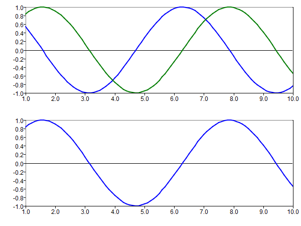

figure;
x = 1:0.1:10;
subplot(2,1,1);
plot(x, cos(x));
ax1 = gca;
subplot(2,1,2);
plot(x, sin(x));
ax2 = gca;
hold(ax1, 'on')
plot(ax1, x, sin(x));
      Figure 2. Set hold 'on' on axesComments
If hold is called without an option argument then the state will be toggled. If hold is called without an hAxes argument then the hold state of the active axes will be set.
Note that hold(hAxes) or hold(hAxes, option) will not change the active axes to hAxes (See also Example 2).
