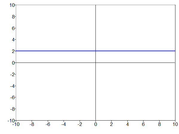

clf;
        h = yline(2);

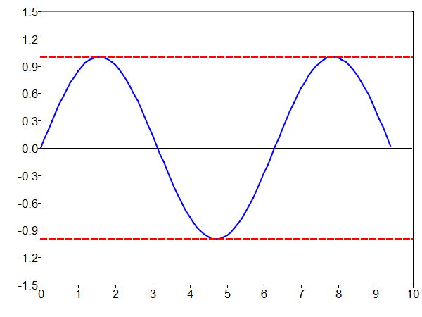

        Figure 1. Horizontal line at y = 2clf;
          x=[0:0.1:3*pi];
          plot(x, sin(x));
          h = yline([-1;1],'color','r','linestyle','--');
          ylim([-1.5 1.5])
        Figure 2. Create 2 lines and set propertiesComments
