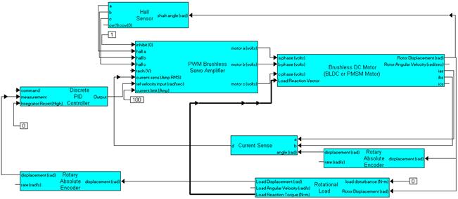

Place the following eMotors blocks in your diagram:
•PWM Brushless Servo Amplifier
Flip the Rotary Absolute Encoder and Hall Sensor blocks using the Edit > Flip Horizontal command. Then arrange the blocks and wire them together, as shown below.
In this application, there is no reason to reset the integration of the PID Controller-Digital, so a 0 const is wired to Integrator Reset (High) to disable it. In other applications, repetitive control may be used, and Integrator Reset (High) may be required to re-initialize the control between repetitions.
A value of 100 amps is chosen for this example to make certain saturation does not occur. Later on, you might possibly measure currents encountered in this simulation under highest load conditions and set a more appropriate current limit for the final design.
Next, place the following eMotor blocks in the diagram:
Flip the Rotary Encoder and Rotational Load blocks and arrange the blocks as shown below:
Connect the Rotor Displacement output on the Brushless DC Motor-Digital these three blocks: the shaft angle input on the Hall Sensor block, the displacement input of the Rotary Absolute Encoder, and the Rotor Displacement input on the Rotational Load.
Connect the outputs of the PWM Brushless Servo Amplifier to the corresponding inputs of the Brushless DC Motor-Digital. Connect the Load Reaction Torque output on the Rotational Load to the Load Reaction Vector input on the Brushless DC Motor-Digital.
Lastly connect a const block with 0 set value to the load disturbance input on the Rotational Load. If there were other torques related to influences that could not be directly represented by the set parameters of the rotary load model, the load disturbance input provides a method for introducing such torques. For the target tracker, it might be conceivable to introduce torque noise induced by structural vibrations of the tracker mount. If the mount were part of a satellite payload, such vibrations could arise from solar array positioning systems. Noise profiles with specific power spectral densities can be generated in Embed using the Random Generator blocks and transferFunction block. Coefficients of the transfer function are determined by applying spectral factorization techniques to the known PSD.
Next, insert a Park Transform and a Clark Transform into the diagram and connect them as shown below:
Encapsulate the blocks in Current Sense. Then label the input and output connectors as shown below:
Flip the block and connect the ias and ibs outputs on the Brushless DC (BLDC/PMSM) Motor to the corresponding a and b inputs on the Current Sense. Connect the displacement output of the Rotary Encoder to the angle input of the Current Sense.
Connect the Load Displacement output on the Rotational Load to the displacement input of the other Rotary Absolute Encoder.
Complete the wiring by connecting the output on Current Sense to the current sense input on the PWM Brushless Servo Amplifier and the rate output on the Rotary Absolute Encoder to the tach input on the PWM Brushless Servo Amplifier, as shown below:
This diagram represents a cascade control loop. The inner loop senses and controls current; the middle loop senses and controls velocity; and the outermost loop senses and controls position.

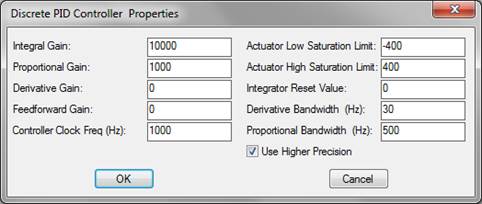

PID Controller (Digital) block

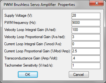

PWM Brushless Servo Amplifier block

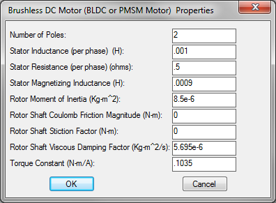

Brushless DC (BLDC/PMSM) Motor block

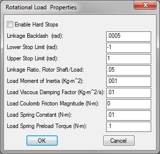

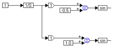

Create the following block configuration:
This creates an elliptical motion for the target in the X-Y plane. Frequency for each axis is the same (1 rad/sec); however, phase differs.
