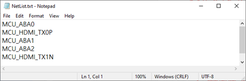

- Net Define File: Select a net definition file. The contents of the
file are shown below:
Figure 1. Net Definition File Contents - Jumper Component: Select a jumper component and verify the existence of a test point at both pins of the jumper component.
